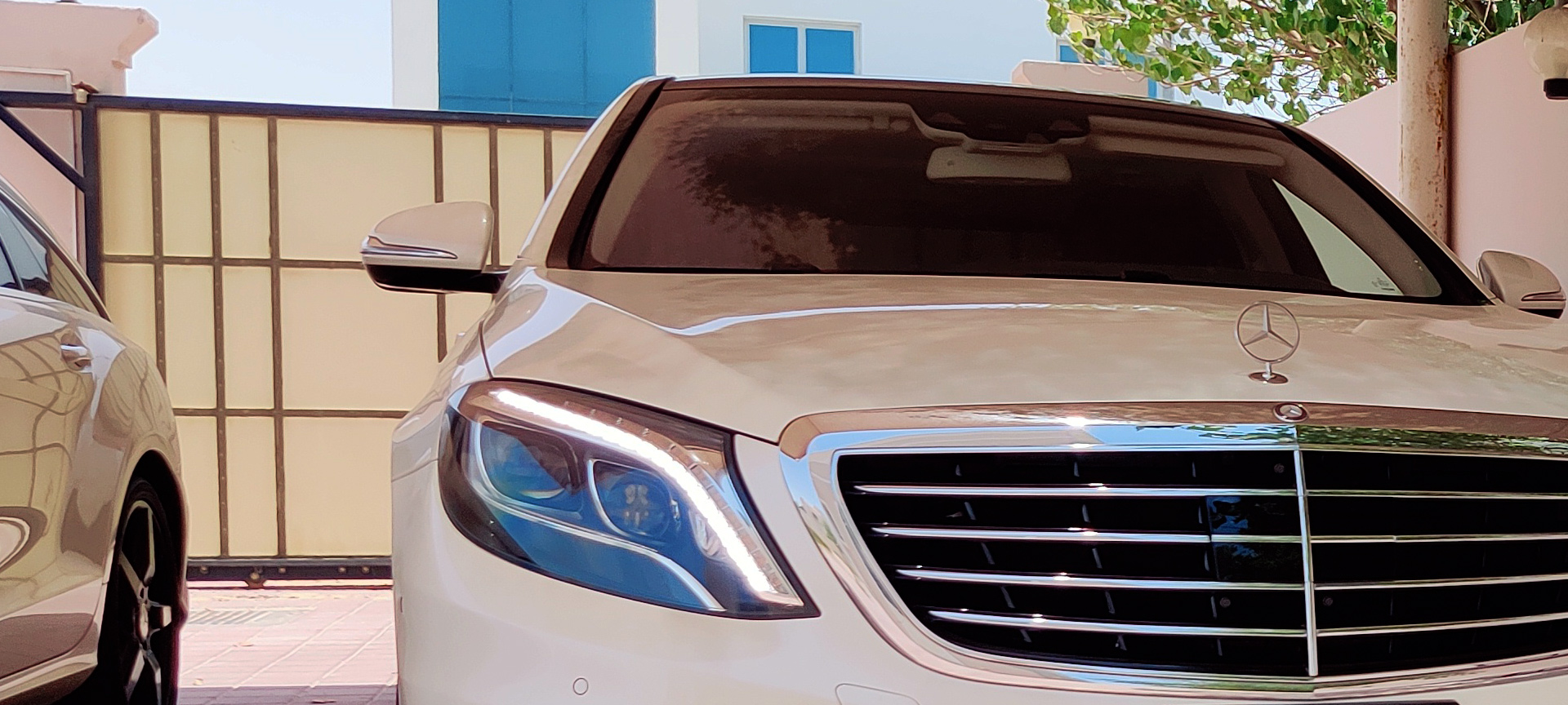

Japanese specs W222 edition 1 (late 2013 model) - does this car have DRLs LEDs? When turned on via menu on the dash, daytime lights simply turn the road lights on permanently on... I was expecting these "eyelashes" LEDs alone to be functioning as DRLs, but it's not the case - apparently these are considered "parking" lights. Can anyone comment? Could it be just some weird Japanese coding I am yet to figure out how to change?

Yeah, this option, when switched on in the cluster - turns on both: parking lights and road lights. It's like turning your lights on manually.

I managed to figure it out... I kept assuming that I need to turn something ON for this to work, but that's not the case. When you activate DRLs from the cluster Lights menu, Japanese spec car will turn on both - road lights (inner and outer) along the LED "eyelashes". These LEDs are also dimmed. In order to make this work, I basically started tackling every option that contained TFL in the name, working with BC_F222 module.
Options to be configure are PLSM_TFL_ABL - this must be set to OFF in order to disable headlamps lighting up with eyelashes LEDs
PLSM_TFL_STL - this must be set to OFF in to prevent dimming of eyelashes when running as DRLs.
optionally: PLSM_TFL_AVL when set to Off, it will completely disable the eyelashes and keep the main lights as DRLs...
Result:
