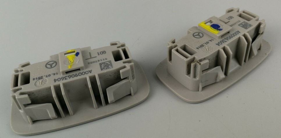

Carefully pry loose preferably using plastic wedge. Here’s the underside.

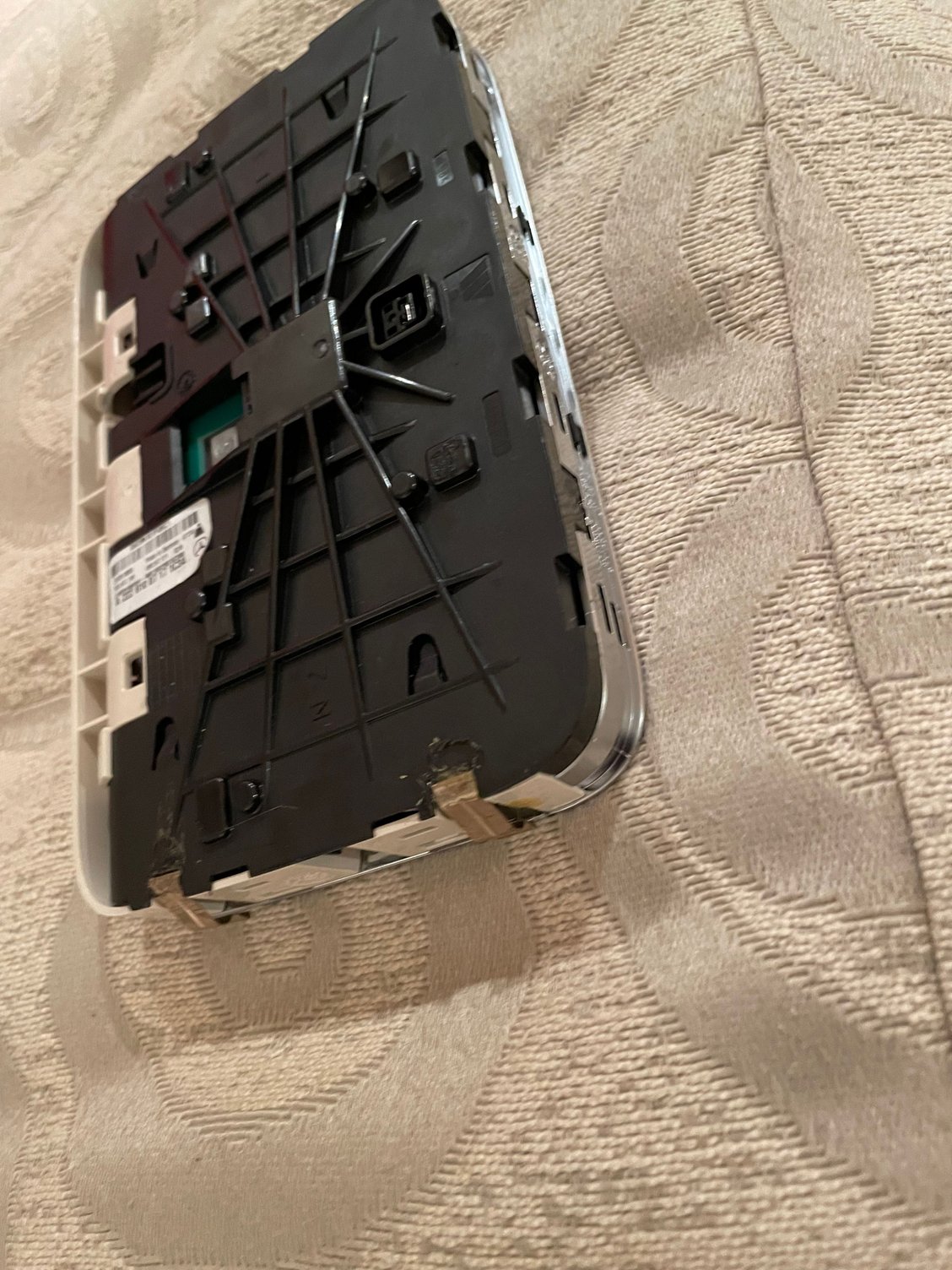

I haven’t diagnosed my rattle yet, but here is the light from a 2018+. The metal clips are on the drivers side. You have to insert a thin piece of plastic and pull down from that side.
