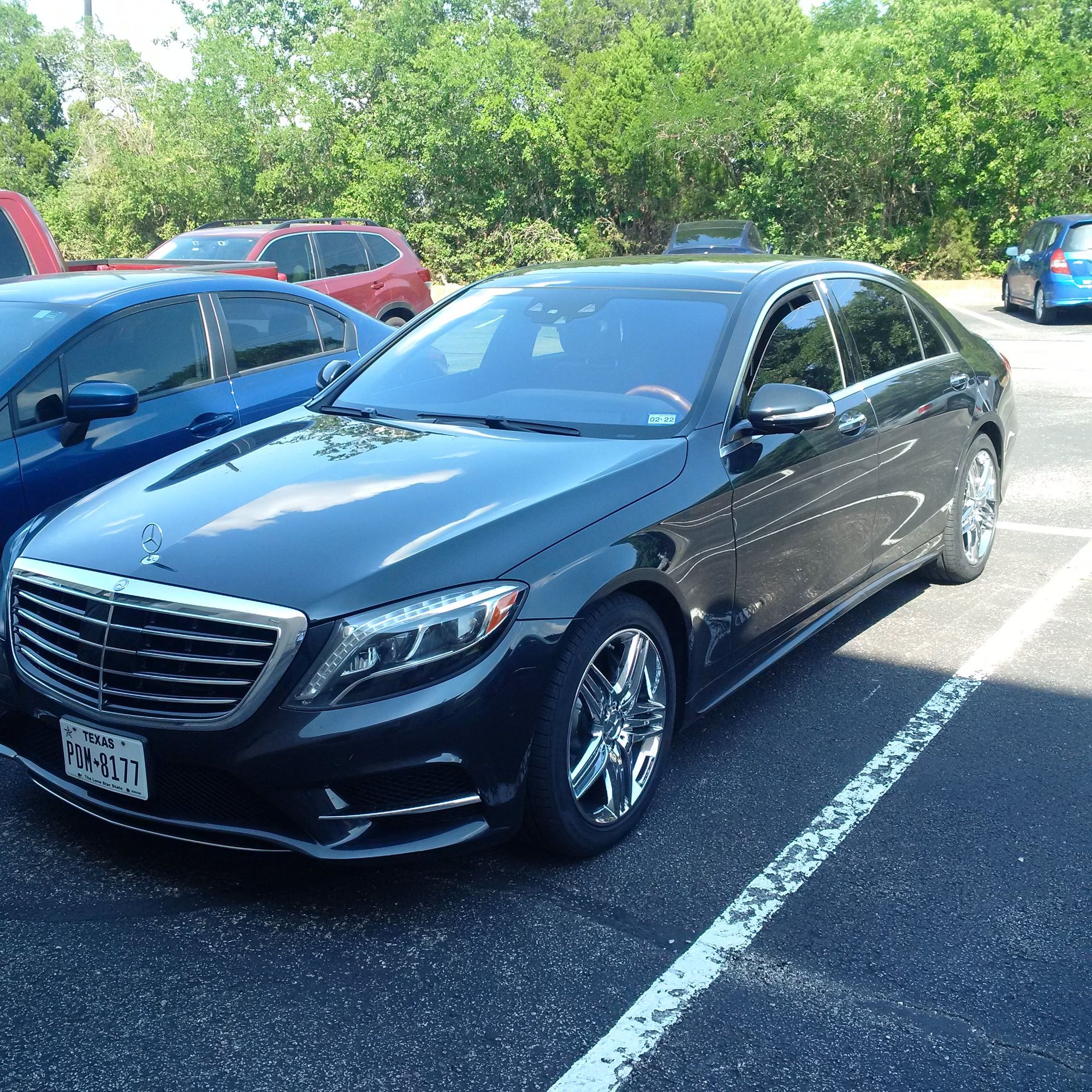

Today, I completed my wheel & tire changeout. I took off the original-equipment staggered 20" AMG wheels and Pirelli run-flats and replaced them with four, 19 x 8.5" W221 AMG wheels with Pirelli Cinturato P7 AS Plus tires. Since the pros and cons of staggered wheels have been discussed here many times, this post will simply document the process I followed and mention a few details I learned along the way.
My main objective was a more luxurious ride and after one day, the difference is immediately noticeable and just what I hoped for. Bumps and expansion joints the car used to bang over now go by with just a soft thump and the car is noticeably quieter on all road surfaces. It's going to be a real pleasure when we get out on a road trip.
I had the Cinturato P7 tires on my previous car and am noticing them more and more on BMW and Audi cars, so I know they are excellent tires. They score very highly on Tire Rack's scale for noise and ride comfort and have a higher score for steering response than Bridgestone Quiettracks that some here are fond of. Since these high-rated comfort-oriented tires are not available in size 275/35-20, I felt there wasn't a good option to get more comfort and quiet with the 19 or 20" staggered rear wheels, at least not using Tire Rack ratings. This was my primary reason to go square, to get the tires I wanted. But there are two other benefits as well: first, I can rotate the tires to get more life out of them and second, if I had a rear tire blow up on the highway somewhere, I'd have many more options to get a replacement 245/45-19 tire to continue the trip. I fear that 275/35-20 tires could be hard to find in out of the way places.
So, the issues I ran into doing the changeover:
1. The particular 19s I chose had a 43 ET vs. 38 on the OEM wheels. There are 19s with 38 ET, but I liked the style of the wheels I chose and decided the 5 mm difference wouldn't be particularly noticeable
2. In back, I compensated for the 1" narrower wheels by adding 15 mm spacers. With these I had to track down longer wheel bolts with 60 mm shanks. These are not available (that I could find) with the factory "flower" caps, so for the moment, I have different bolt types front and rear. I will probably buy aftermarket 45 mm bolts for the front someday, but am in no hurry as I have both wrenches
3. The tire load index spec is a little odd. On the 18 inch factory wheels, it's 100 all around but on the staggered wheels it's 99 in front and 102 in back. Since I'm not planning to take the defensive line with 600 lbs of luggage to the airport, I don't think there's any harm in having the same load index for all four wheels
4. And finally, the staggered rear 20s with tires are freakin heavy! I think I cut unsprung weight by about 20 lbs on each side of the car!
Hope some of this is helpful to anyone else pondering the staggered wheels and RFT tires!

Dave, interesting points, thank you. I would love to have been able to try your car and see how good those General G-Max tires are on 20" wheels. I did look at their Tire Rack ratings and they're probably great tires, but they aren't in the top tier in ride and noise comfort, at least in Tire Rack's system.
The load index business is a bit of a puzzle to me. A 99 rating says each tire can support 1,709 lbs, a 102 is 1,874. My reasoning is if Mercedes allows something between a 99 and 102 for a 4,600 lb S550, there must be a fair margin of safety in that range. Does a wider/taller wheel/tire require more load capacity? I'm sure I have more to learn about these ratings, but it seems four 99-rated tires would support ~ 6,800 lbs and that is well beyond the GWR on the fuel filler door (6,019) and any weight I ever expect to carry.
EDIT: Dave also brought up the "XL" or load rating of the tires, and this is also a bit difficult to interpret. XL-rated tires are reinforced to operate with higher air pressures (up to 41 psi) and are also specified for "high-performance" vehicles. When I researched this in my owner's manual, I found that a RWD S550 with summer tires can have different load ratings, just like it has different load index values:
  1. 18" wheels and tires are spec'd for "Standard Load" or "SL"
  2. 19" front wheels are "XL" and 19" rears are spec'd for "SL"
  3. 20" wheels are "XL" front and rear
Since I plan to run my tires somewhere in the 32 - 35 PSI range, I don't feel concerned about using SL tires.
I was a bit surprised after taking off the 20s to find that the tires actually have more tread than I thought. Three measure at 9/32s and one at 8/32s. Not sure what I will do with them; the obvious answer is to sell them as a easy bolt-on upgrade to someone locally. But if I can find room, I might keep them for the day when I sell this car so I can put it back to the original config for the next owner.

The wheels are Mercedes OEM, made in Germany. Two were newly-chromed and beautiful; the other two were dirty but cleaned up pretty well. I paid $475 ea for the nice ones, and $425 ea for the dirty ones for a total of $1,800.
Happily they all balanced perfectly and ride like a dream. I was a little anxious one or more might be bent or have some flaw, but all four seem to be good wheels.

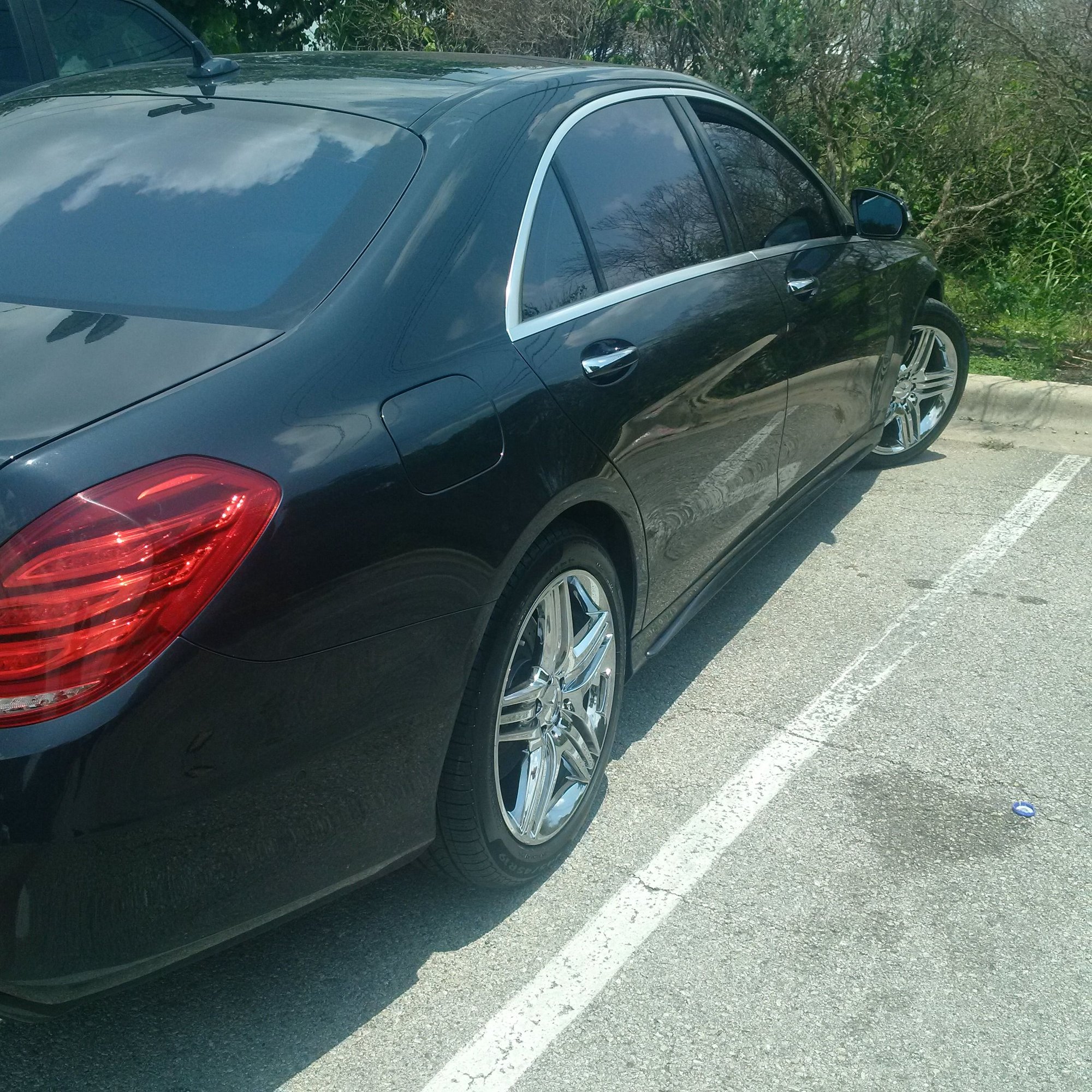

Another pic of the finished result ...
Oh, ok, one more ...

Old Jun 23, 2021 | 03:57 PM
Tom in Austin's Avatar
Joined: Aug 2017
Posts: 1,697
Likes: 523
2019 S560, 2015 Honda Civic Hybrid
The AMG 19s I used fine fit over the AMG sport package front calipers.
With 8.5" wheels in back and 245mm tires instead of 275s, I'm sure there's less traction than with wider wheels and tires.
Even the valet at Truluck's approves our square set-up, he left our car out front all evening while we dined!
