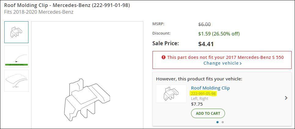

The clip to the rear of this trim piece is broken. The clip is at the very end of the trim piece near the rear window. Stopped by my dealer and a very helpful tech gave me good news and bad news. To replace the trim piece is 700.00 parts and labor. The clips cost 34.00 and if he is able to order just the clips the cost would be around 150.00 parts and labor. When he went inside to look up the clips he said the screen showed yellow clips instead of green clips and didn't know if they were the same. He said he'd try and order just the clips.

Here's what EPC shows as it pertains to water deflector (100 in diagram), see attachment for part #s.

Thanks Konstiger!!!
He ordered
2229910198 and
229910398
I'll show him your PDF
Thank you

2229910498 & 0598 are for Panoramic (code 413).

roof clips
In the PDF 222 991 05 98 appears to be the correct clip. Is that so?

Yes, you have Pano roof so correct part(s) will list code 413 on parts list previously posted.
