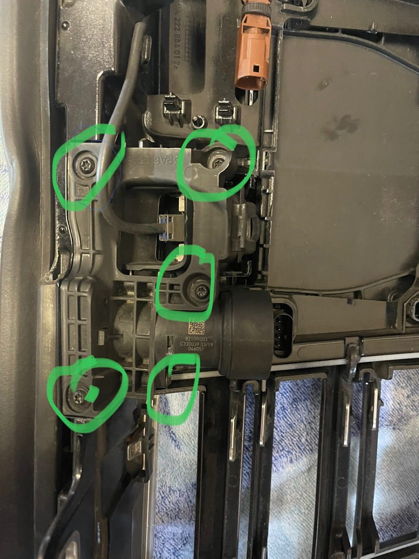

I recently replaced the door that goes over the camera, the Chrome trim had become lost! Below are the steps that I took for that process.
The install wasn’t too bad, four 10mm bolts across the top of the grill, and then pull the grill forwards. There are three clips across the top and two on the bottom that hold it in place after that, I used a trim removal tool to gently pry the grill forward for the top clips, the bottom ones pulled out on their own.
Next, detach all of the electrical connectors, I had 3.
From here, place the grill face down on something soft, there are five torx screws holding the camera assembly in place, take them all out.
Push the camera door so that it’s wide open, and pull the camera out.
The door has a spring on it, take note of where it is!
Unclip the door, and your ready to go in reverse. Putting the spring back on the door was a pain, but after that it went quickly.
Camera held in with 5 torx bolts/screws
