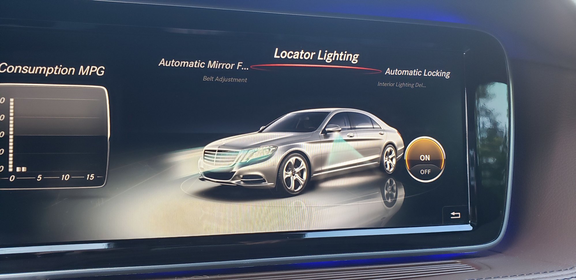

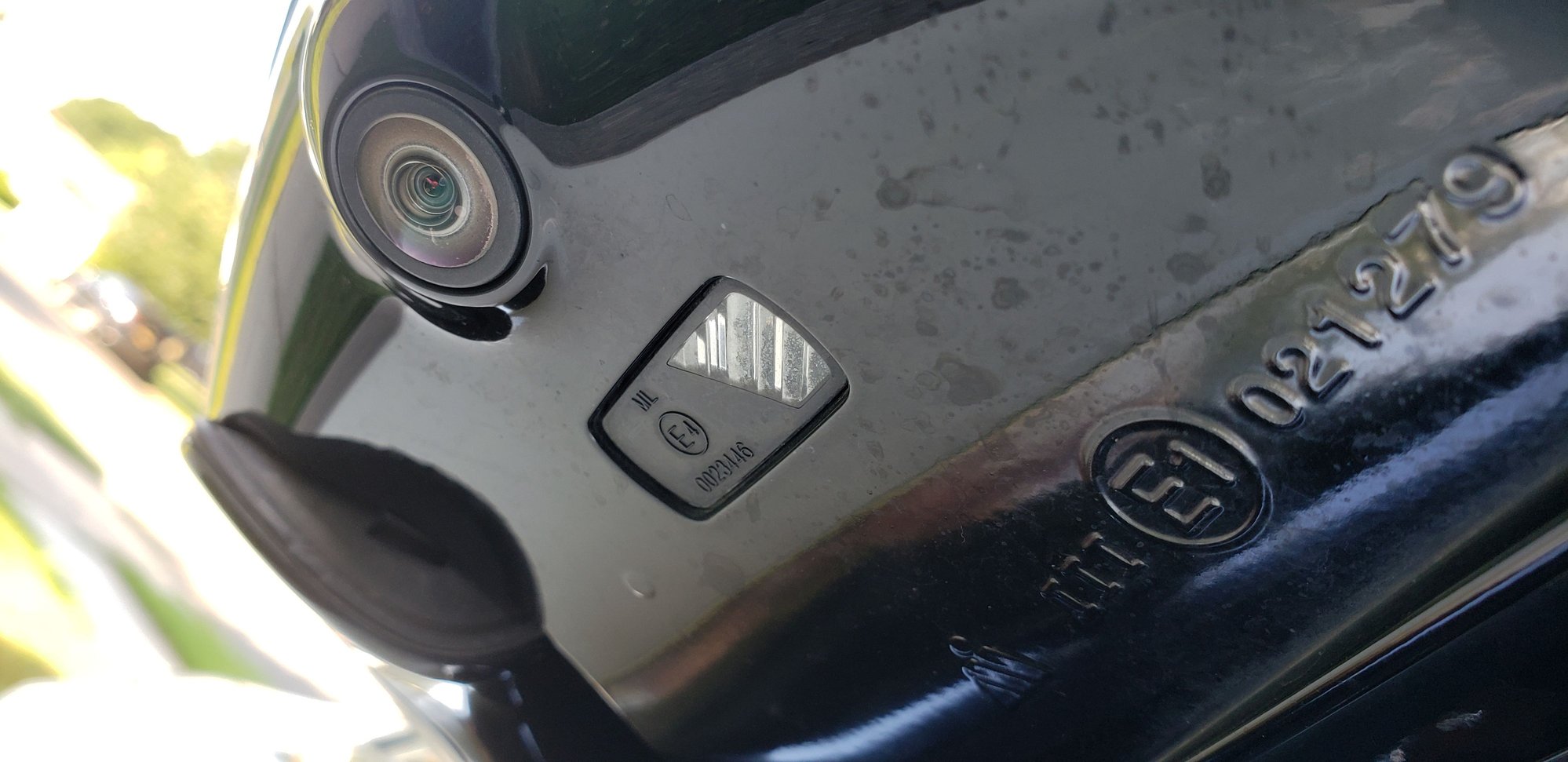

Can anyone clarify if I have locator lights on my rear view mirrors?
I'm confused. The command center shows the option to turn them on and off. But the lights don't work.
See pictures.
Bottom side of rear view mirror

Yes you have them and they are probably burned out. Pretty easy to replace and several youtube videos are out there to cover this.

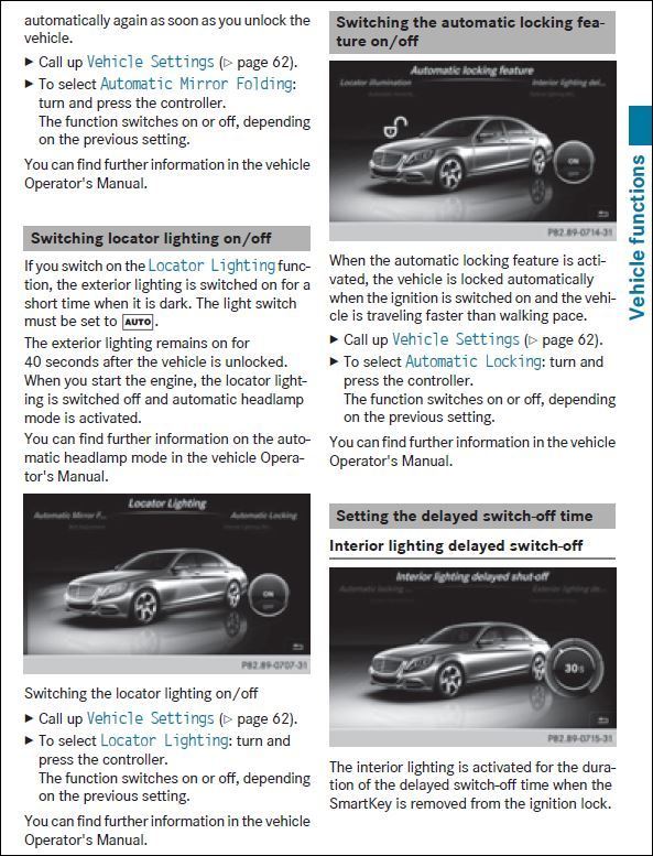

Is light switch set to AUTO.
