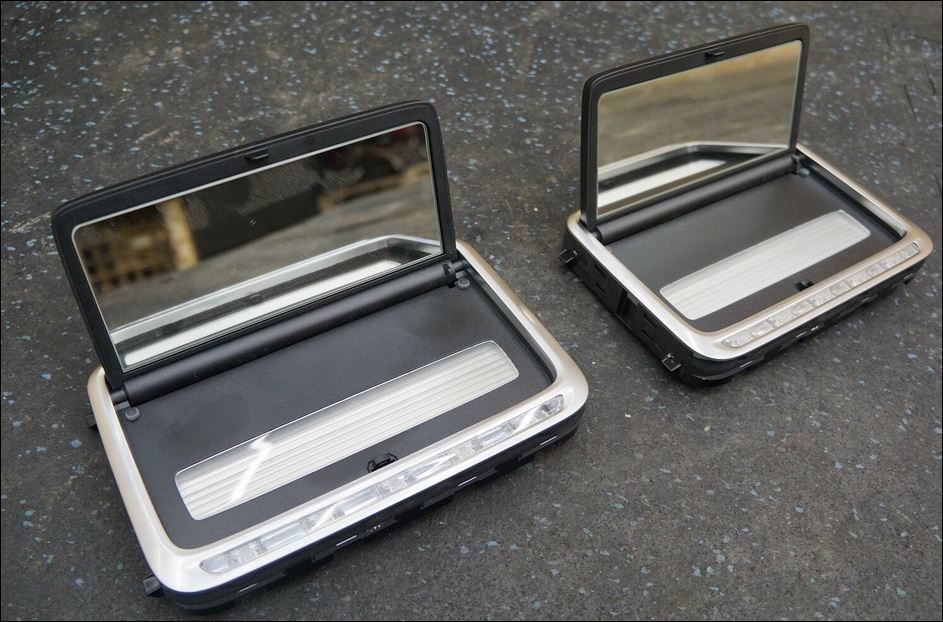

Need some assistance on my rear passenger vanity mirror. The light stays on even with the mirror folded up into the closed position. I can turn on/off the rear driver side vanity mirror but the passenger rear stays on. Any help greatly appreciated as I just received my vehicle and am getting use to the controls!

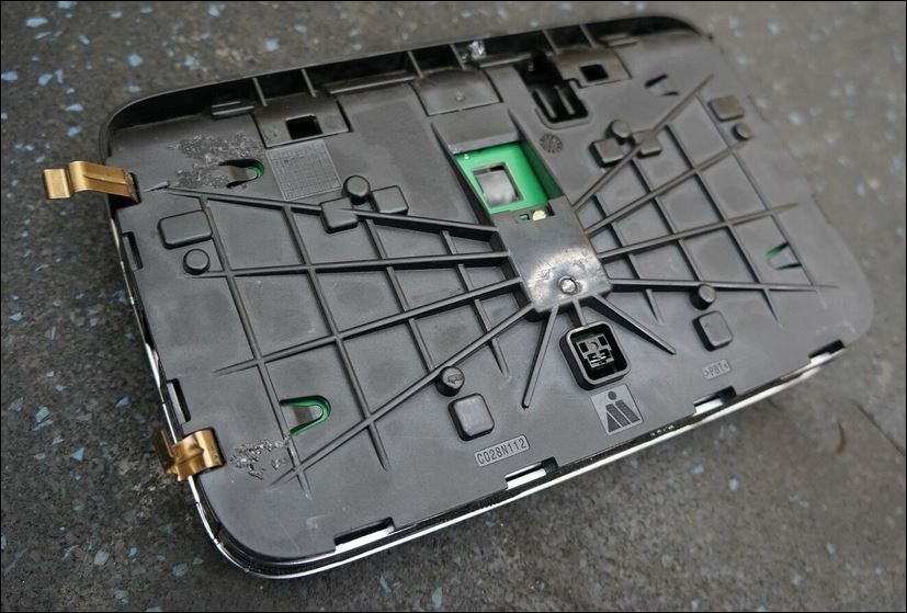

Visually inspect contact switch where mirror tab meets base may need cleaning or alignment. Fine, remove vanity using plastic wedge (see side holding clips), inspect connection if fine see if you carefully disassemble vanity to check internals. If not, may need replacement need VIN to supply part #.
