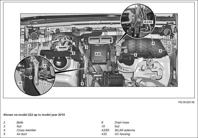

My 15 S550 AC is running fine with no signs of any problems other than I do not see any water drainage under the car while running or after shut off for a while. Am I plugged up somewhere and how do I open up the drainage hose if so.

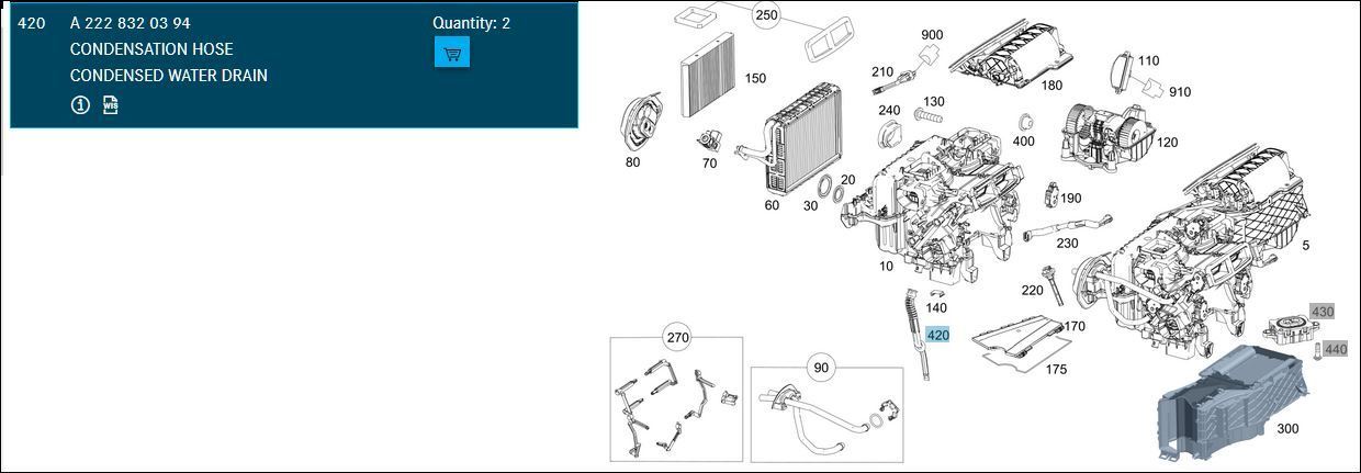

See attachments, should drain beside transmission to inspect remove center console.
