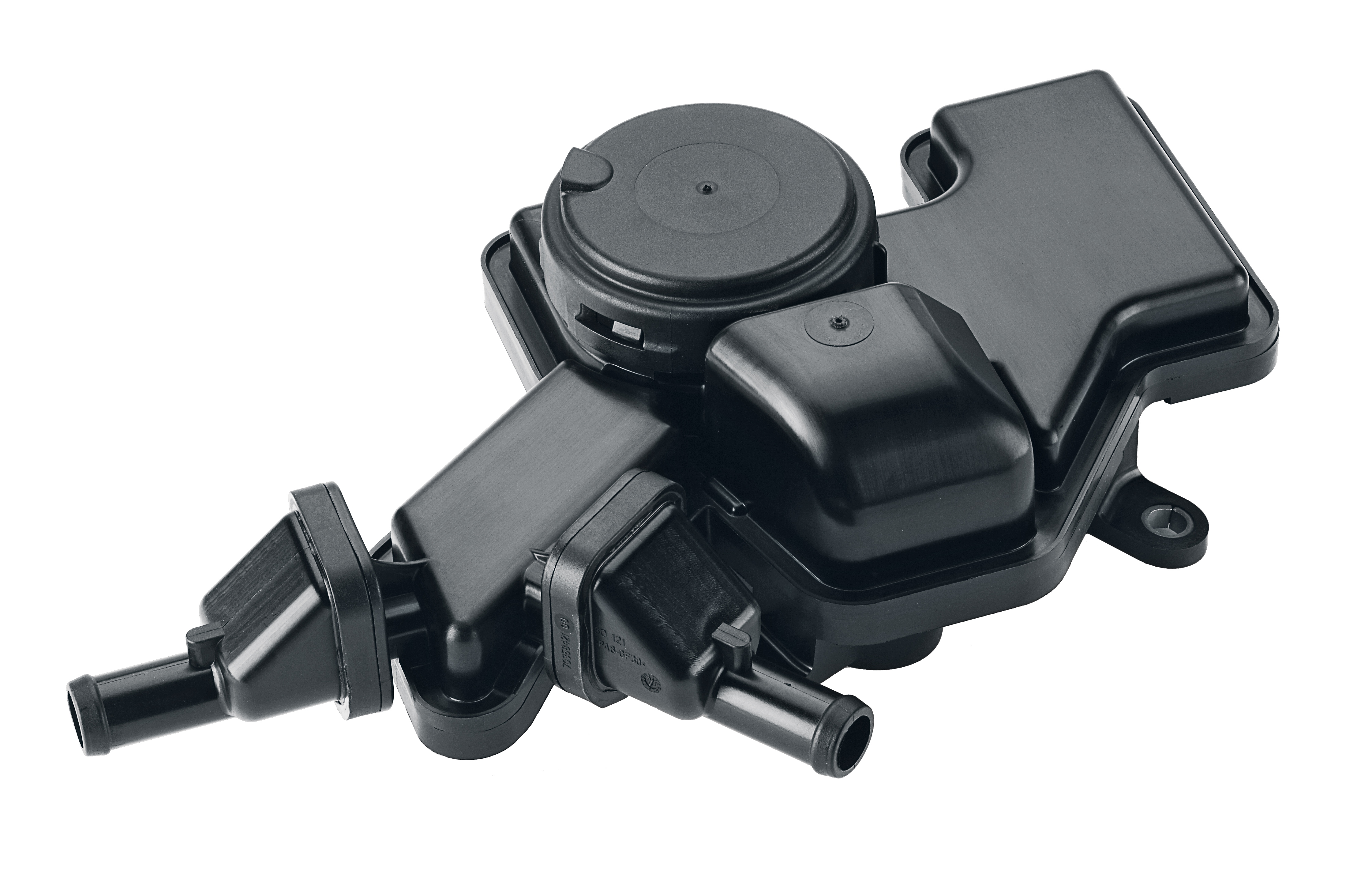

The S560 with M177 V8 does not have the 48V system, which is good. This V8, however, may be developing a reputation rear main crankshaft oil seal failure due to failed (plugged) vapor separator. It's not clear yet whether this applies only to AMG63 variants, or more widely across M177 applications.
Below is a vapor separator from Mahle, the OEM supplier for MB. It is effectively a catch can. Remember the breather caps on the small block Chevy?

@chassis is that vapor separator something that is easy to swap. I have a 2019 S63 with the M177 and 18K miles. I had not heard of this issue but wondering if this is something I should routinely replace.

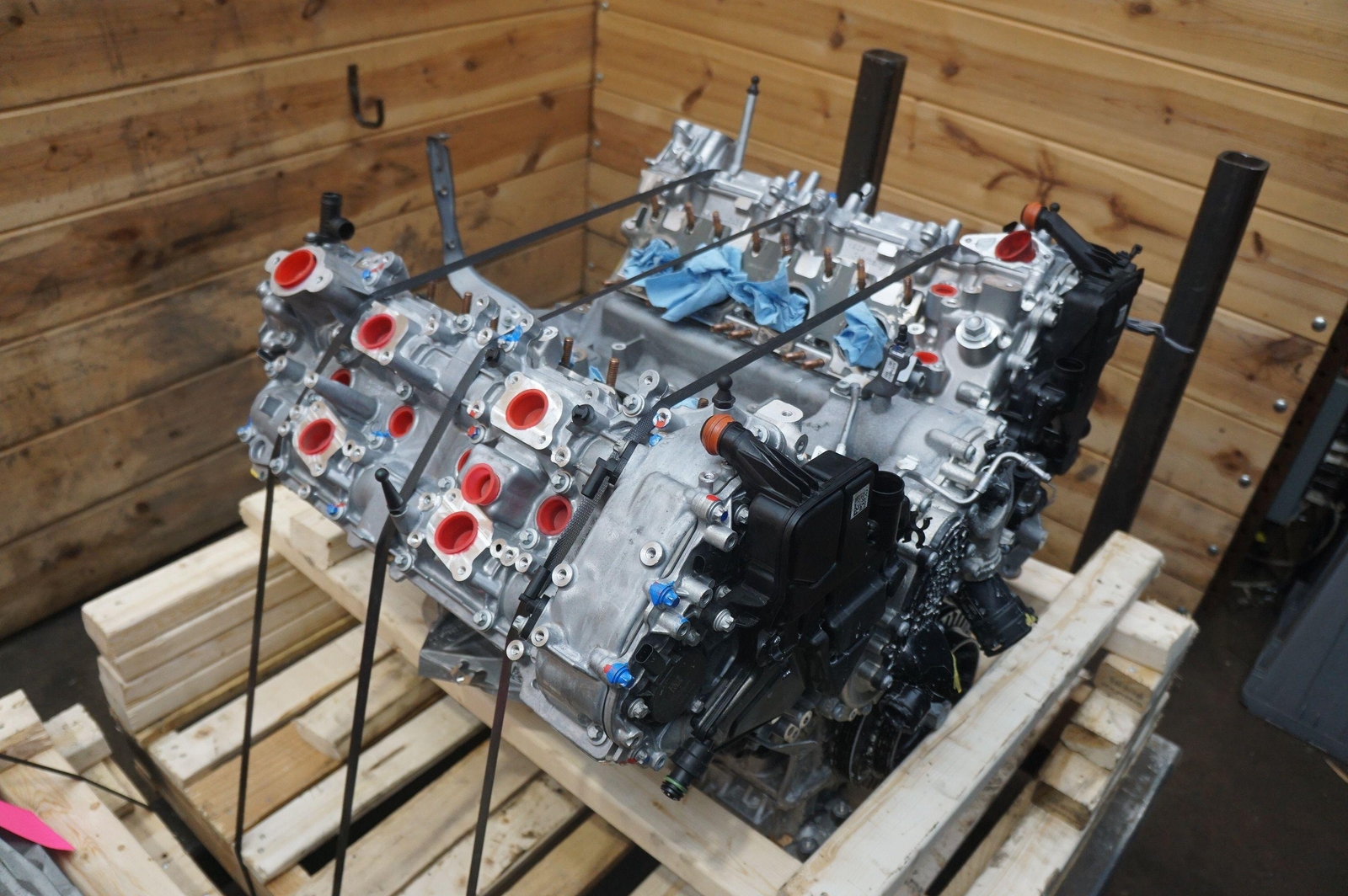

@superpop Pre-emptive replacement of separators is a good idea. If I owned an M177-engined vehicle I would likely change them.
In principal it looks easy to me. However the parts that need to be removed before arriving at the vapor separator could be challenging (time consuming). I think in the W213 AMG section of this site there have been some reports of time and cost to do this. From memory it's expensive, which means time consuming at the dealer.
If you are DIY-ing it, probably not hard because the separators are at the front/top of the engine, best possible location. Parts cost is not exorbitant IMO considering the value of the vehicle and the potential consequences of a failed separator.
As usual with MB engines there are many small fiddly plastic components (connectors, tubes, etc.) which could break when disassembled. Because the M177 is not too old, hopefully heat aging has not affected these parts too much.
Porsche/Audi did it the right way and installed the separators on the top of the cam covers on the EA839 V6 and EA825 V8. Seems the industry has recognized that direct injection engines have problems with intake valve fouling, which enthusiasts have known about for years.
Separators are the black plastic devices front top of cylinder heads. They are catch cans.
There are some components (intercoolers?) between the separators and fan assembly that need to be removed to access the separators. Besides the intercoolers, I am not familiar with each installation of the M177 engine. There will be platform-to-platform detail differences.
