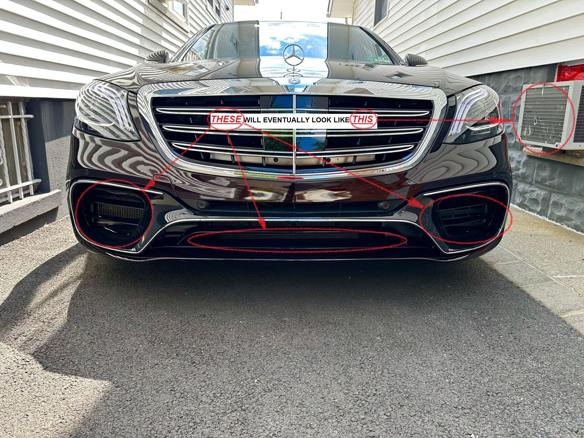

The new front end looks good but are you concerned about the outer lower openings in the grill have no protection from road debris/rocks damaging the auxiliary cooling coils. My lower grill has a cross pattern screen that would hopefully provide some protection. Perhaps you could add those inserts???

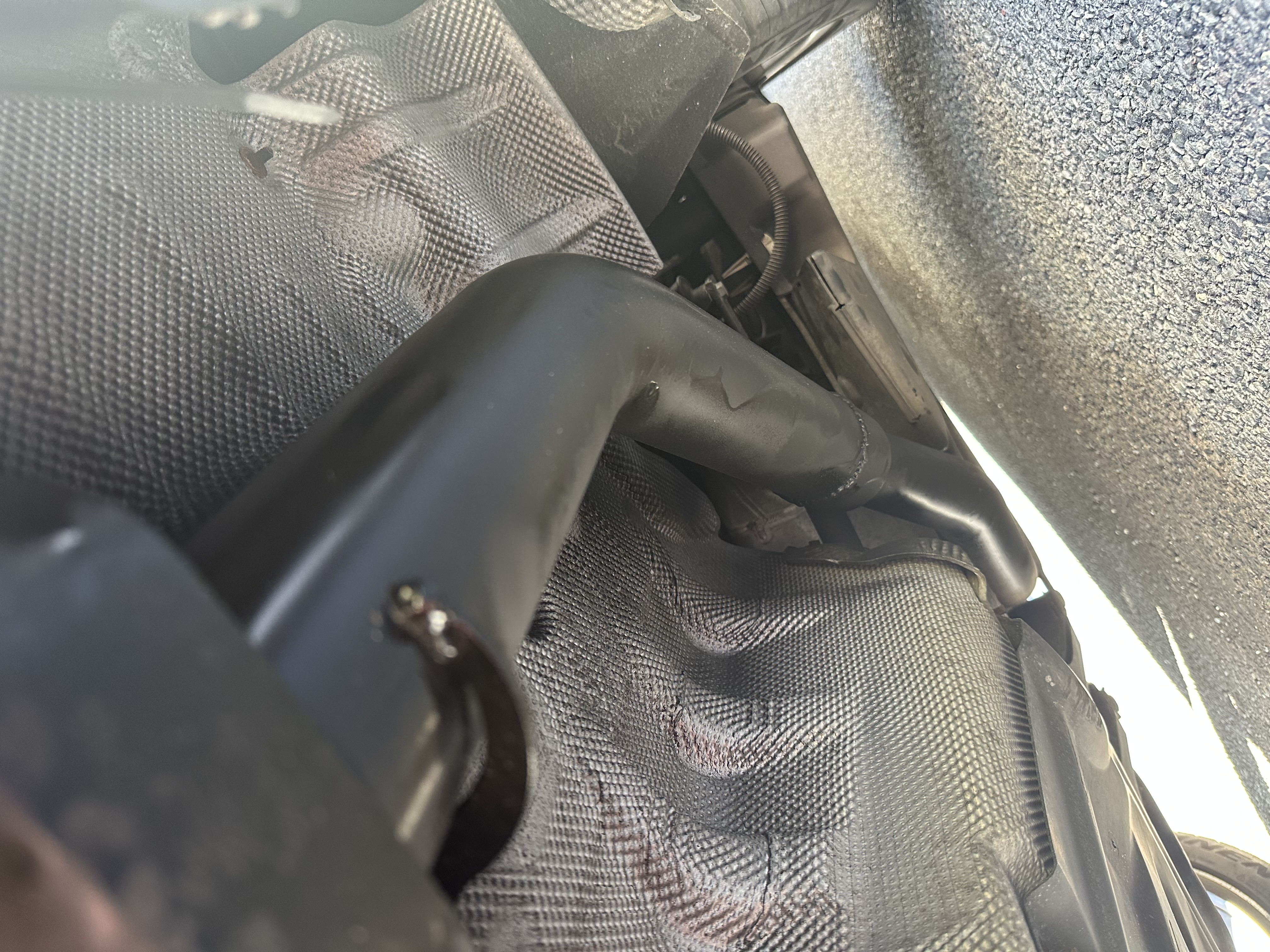

2019 AMG S 65 and too many other vehicles to list here in this small box
Old Sep 11, 2025 | 06:29 PM
superpop's Avatar
Joined: Nov 2015
Posts: 1,691
Likes: 826
From: Newcastle, WA
2019 S63 4Matic+, 2018 E400 Cabrio, wardens car.
I have an authentic 2019 S63 and unfortunately the unprotected coolers in the front are a concern for me as well. I am not sure what to do about this.
Old Sep 11, 2025 | 09:01 PM
SemperFi's Avatar
Veteran: Marine Corps
Joined: Nov 2024
Posts: 219
Likes: 97
From: The Racing Capitol of the World
It appears MB decided to provide some form of protection but only on a few S Class models from 2019. Below are a few pics from the 2019 S Class brochure.
