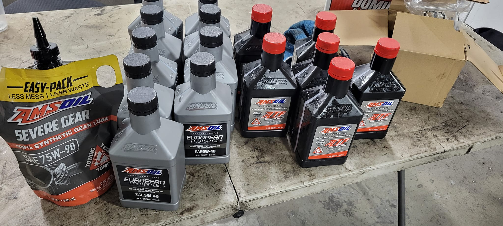

If you want to take the leap, and this is not an MB approved fluid, Amsoil signature ATF FE is compatable and it'll feel better and last longer than the original stuff, there were a couple threads. I personally use it, I also use their DCT fluid in the GTS. Buy 7-9 liters to flush out the system by overfilling it a little bit at a time and letting the excess circulate and drain out.
https://www.amsoil.com/p/signature-s...EA/&zo=7236674
however I understand the desire to follow specs published by MB, so this is the approved fluid readily available with a filter kit for your convenience.
https://www.blauparts.com/mercedes-s...hange-kit.html
I charge $500 for ATF service and filter
I charge about $800 for plugs.
You'll want to do a $170 oil change to get it out of the way
If you don't know the condition of your cabin filter and engine filter do it now, and start changing it annually you'll notice a difference. Mann for everything.
Your shop is right on the money. However you can buy Pentosin ATF134FE on amazon so the idea that you have to order it from Germany is a bit ridiculous unless he's getting the specific Shell Spirax stuff
