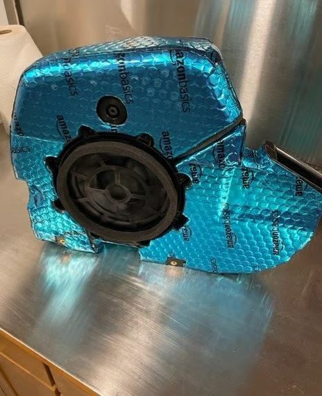

The problem with the Burmester 3D HE system is that it is a pretty closed off system with a few nannies that don't really leave you many upgrade options. The issue is that the command unit (Head Unit) sends all audio signal via a fiber optic cable to the main and sub amp in the trunk area. This in itself is not a problem as there are boxes like the NAVTV unit that can grab this fiber optic cable and convert the audio into analog RCA's or TOSLINK. The only snag is that the HE set up also has microphones in the headliner that constantly monitor the sound and create a feedback loop for the amps to adjust to. This results in very weird behaviors on the overall system. I wanted to upgrade the factory sub box with a nicer Morel sub and JL Audio VXi 1000.1 sub amp with remote. Installed all the gear and it did in fact sound much much better and I could adjust the bass on the fly. After buttoning up the install I took the car for a drive and the sub behaved very erratically. With the windows closed, the sub made a subtle humming noise that sounded like the exhaust was in sport + mode when the car was clearly in comfort mode, but when I rolled a window down, the sub stopped doing this. Never seen anything like this and I have been doing aftermarket car audio as a hobby for over 30 years. Since I was only doing a sub amp and sub speaker enhancement I just grabbed the speaker pair going to the sub and ran that into a line out converter and then into the JL amp. After that I gave up and just ripped it all back out. I did do one thing that I do think helped, I wrapped the plastic factory subwoofer shell in sound deadening and left the Morel sub in as the Ohm and efficiency stats were close to the factory sub. I think that helped a tiny bit. The factory sub amp is a joke though, it is about the size of a pack of cigarettes.
