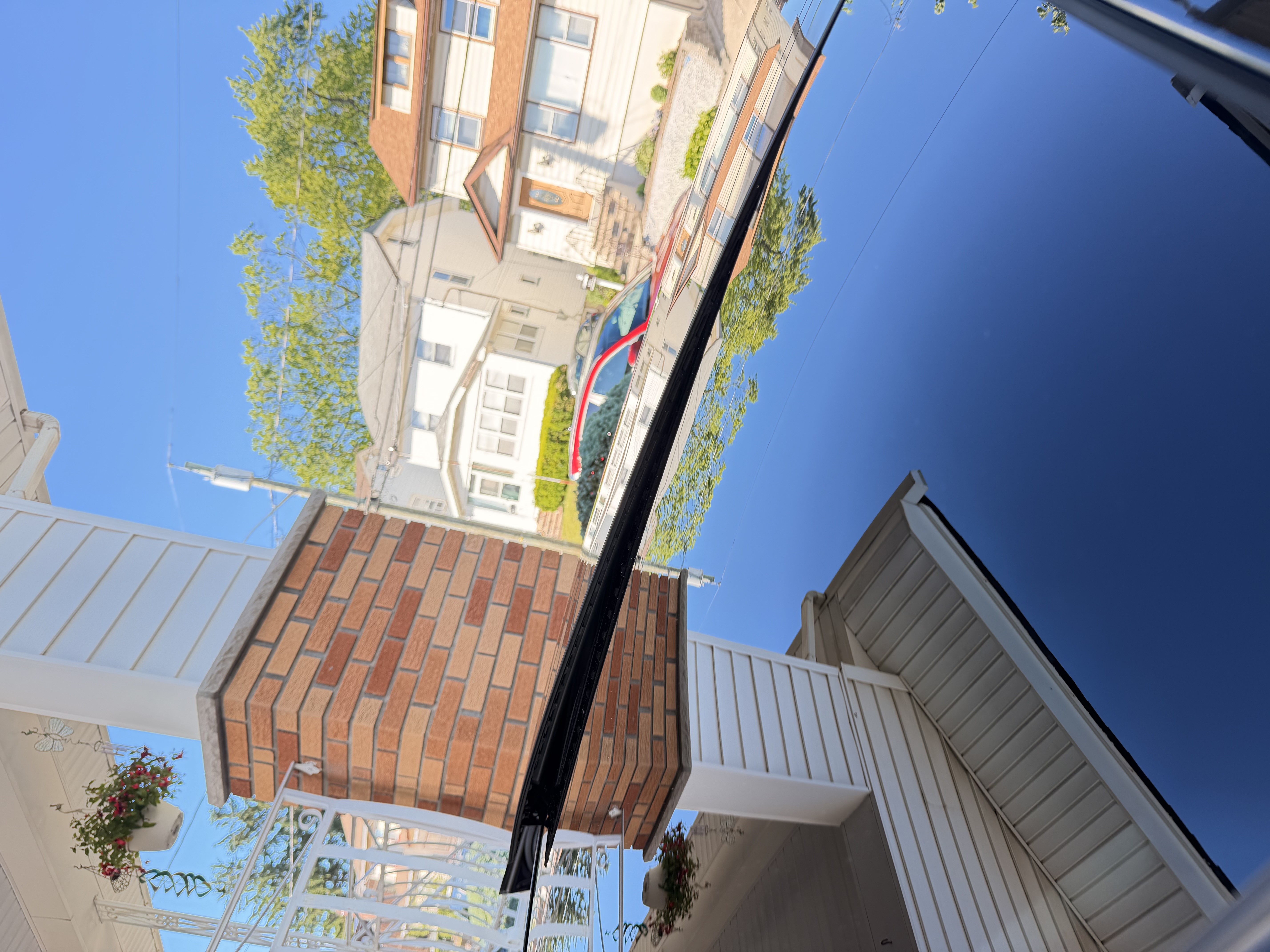

I havent opened my sunroof in a while.. last time I did i had greased the rails etc and now being spring/summer i went to open and noticed half of the sunroof opens.
I looked on both EBay and Amazon but not sure what am i buying if I tackle this project?
YouTube has a very good DIY
Ebay is the sliding track which is https://www.ebay.com/itm/35842564304...Bk9SR7bvnuDPZw
Amazon is the rail bracket
Amazon Amazon
