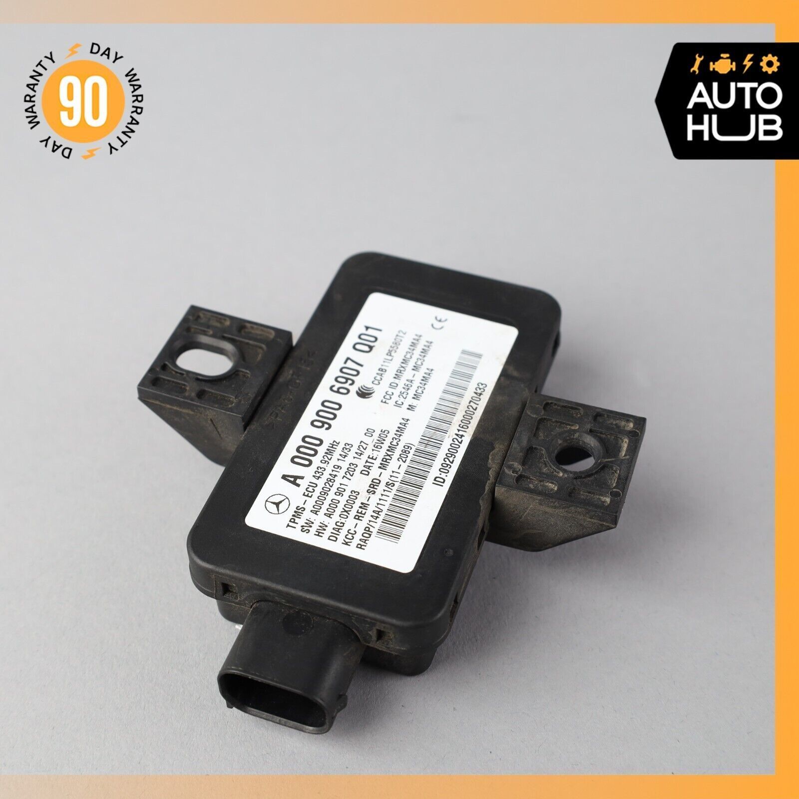

Update ... switched tires from side to side and the "missing sensor" still shows up on the right side, so it's the car and not a wheel that has the problem. I looked around under wheel well and there is a cylindrical plastic device mounted on the strut that's fairly close to the wheel/tire, so wondering if that is what gets a signal from the sensor.
Also did a search on W222 "TPMS components" and found this 'module' that is part of the system but not visibly located in wheel well area close to the tires.
