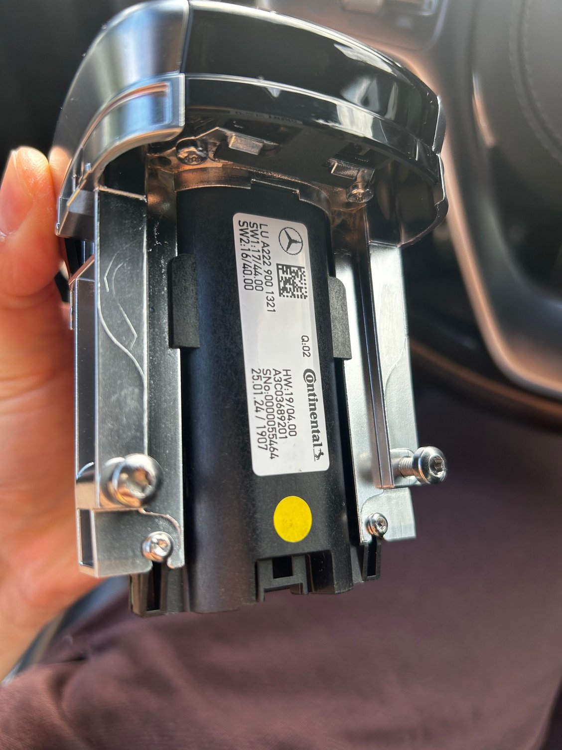

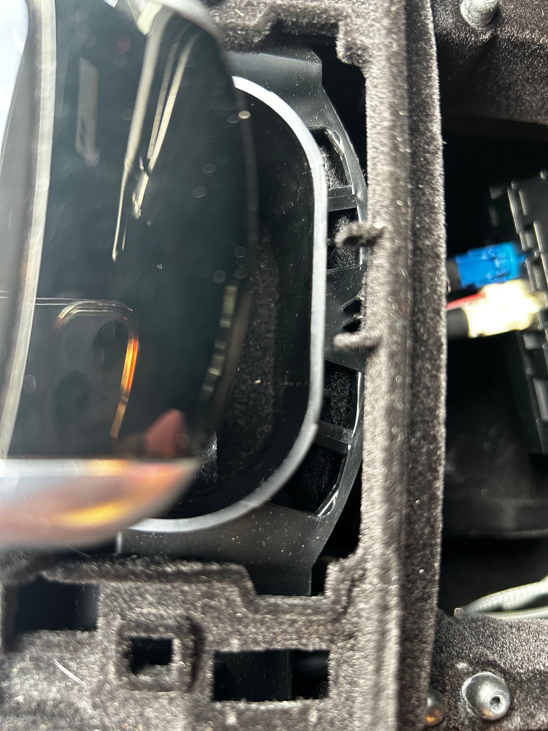

I have a 2019 S450 and my comand touch pad is broke, which I know is a very common problem. Which is why, I was surprised to not find a single video showing the replacement procedure. I found one russian video, but it must have been a pre-facelift model because I do not have the same access to the two T20 screws the guy has through the center console storage compartment:
I am also confused on what the two screws are actually doing. They do not attach to anything as far as I can see. I though the assembly might be clipped somehow but pulling on it with reasonable force did not do anything. I am afraid, the whole control assembly/center console needs to be taken out for it to be replaced.
Has anyone done this or has the WIS?
