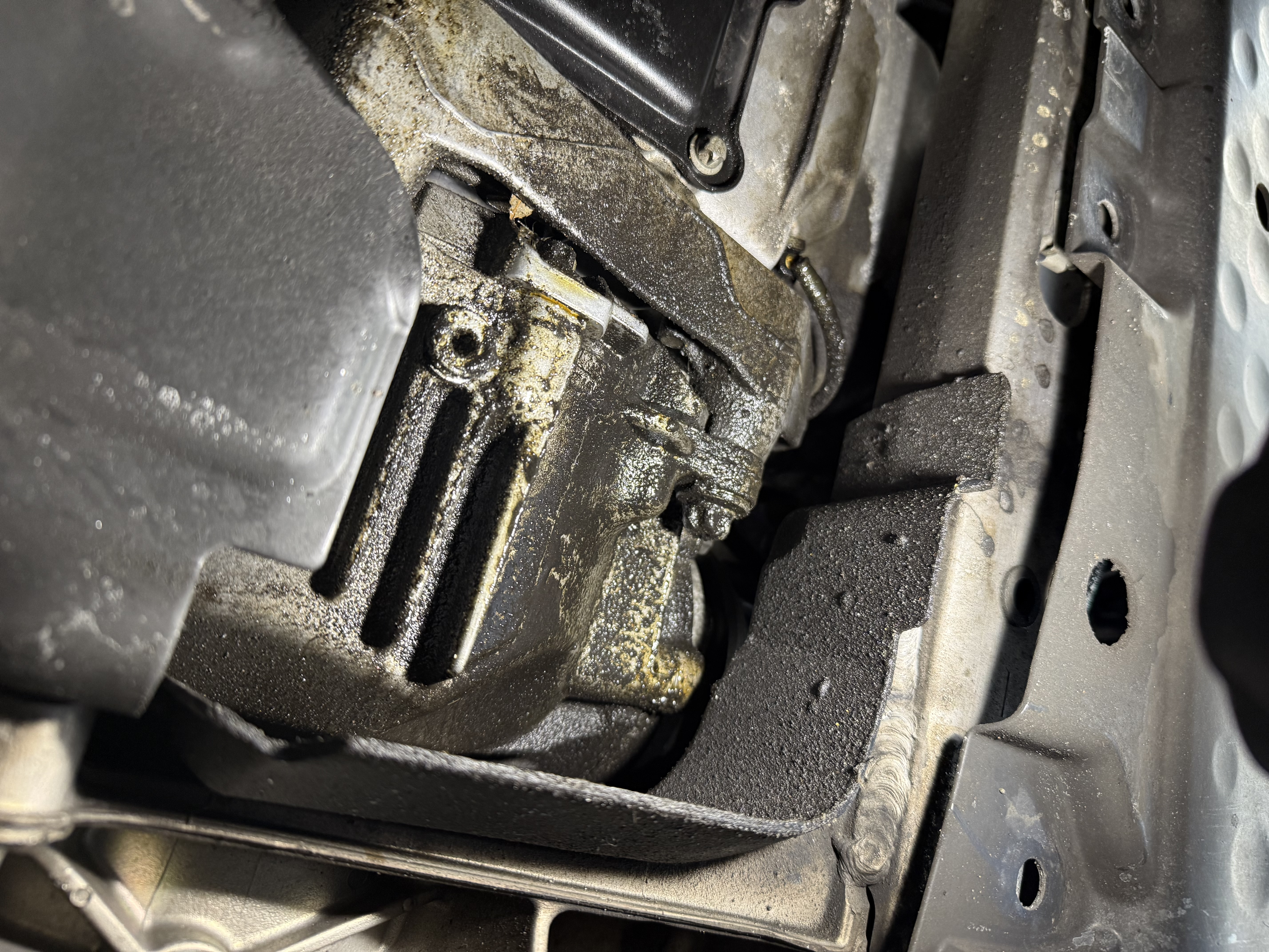

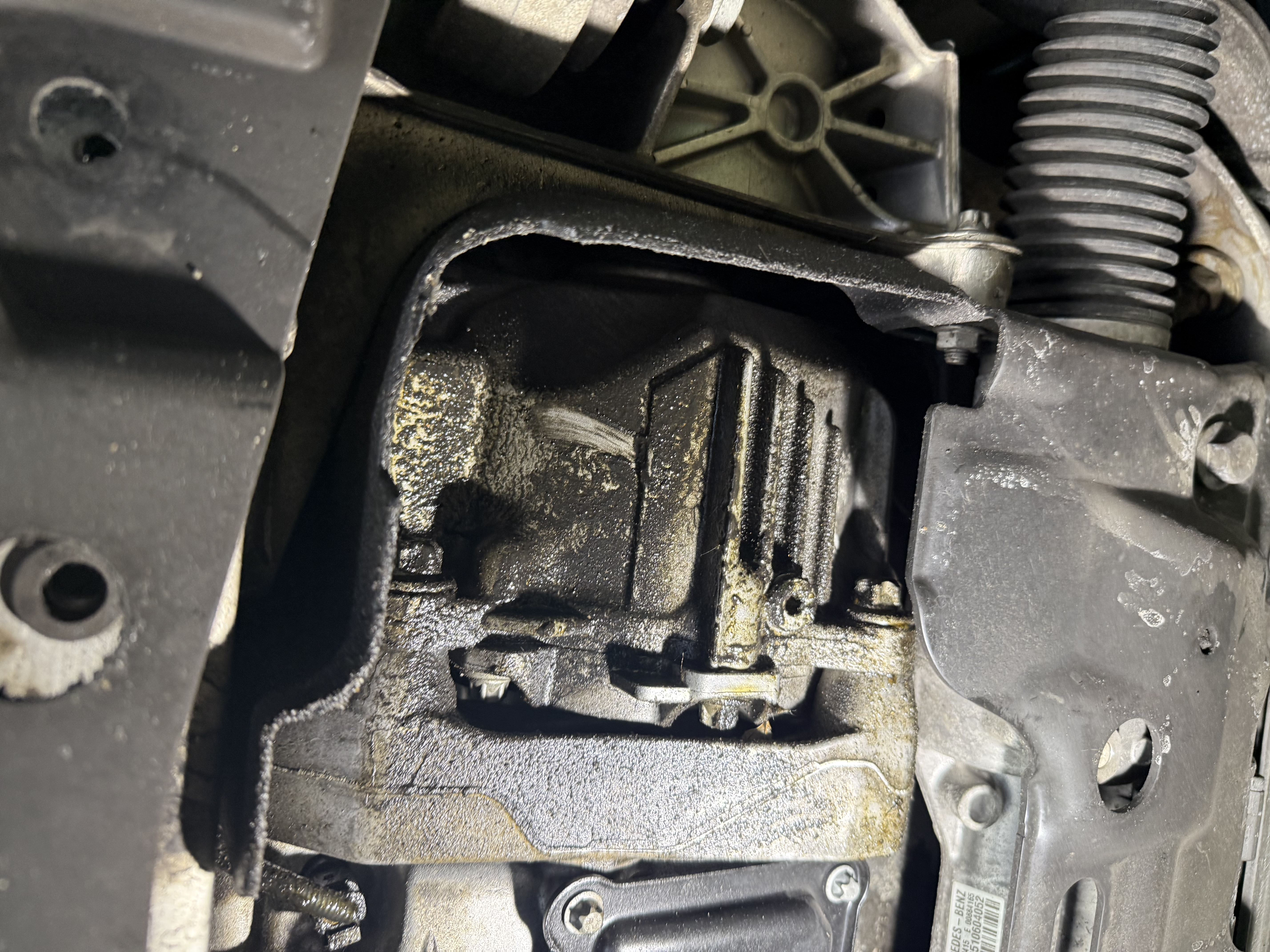

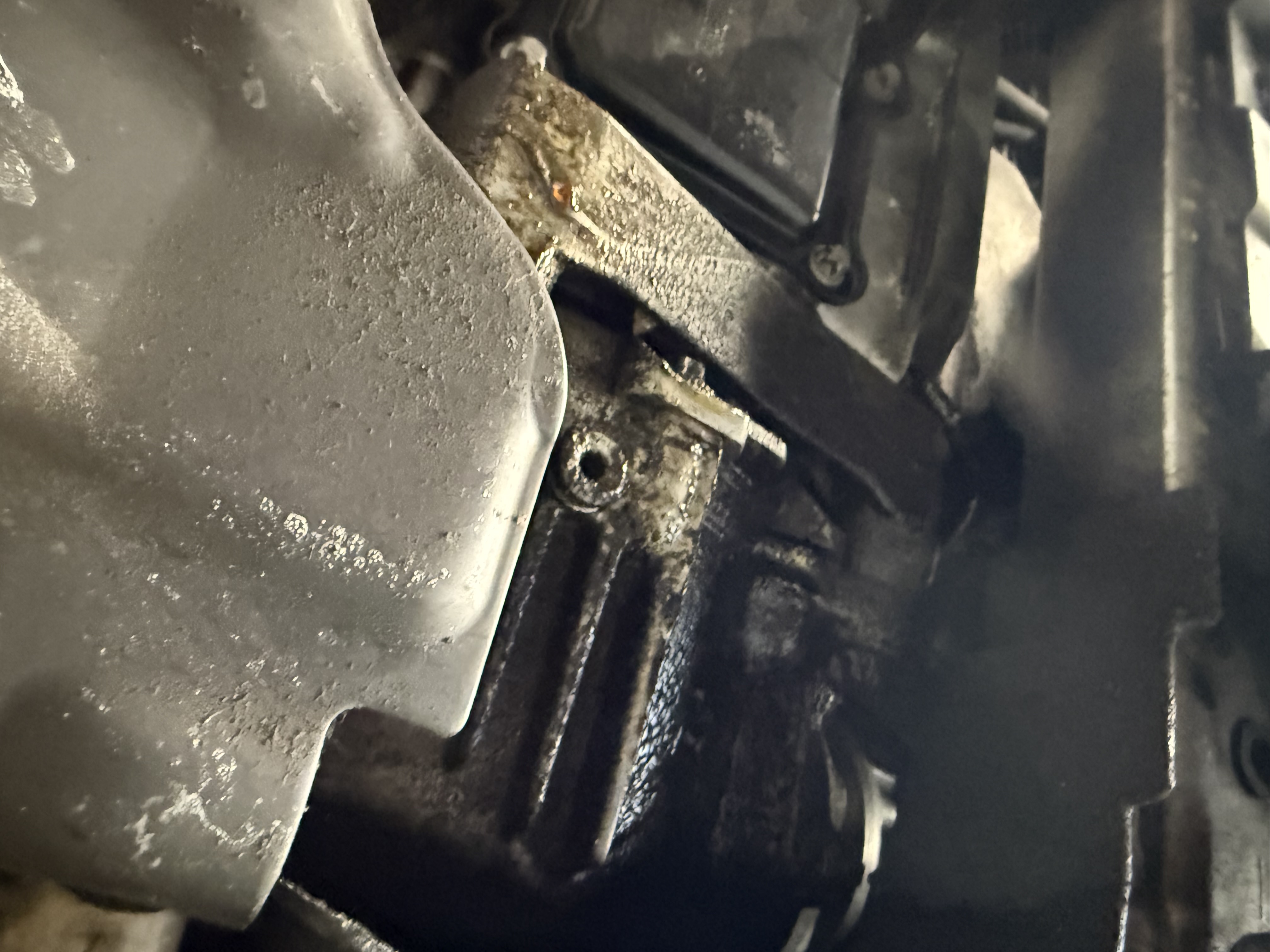

Hey everyone
Question - went to my mechanic today for an oil change and we noticed a slight leak at the axel point passenger front. Mechanic said get a axle shaft seal which I found on FCP. I asked him should I get fluid too and he said yeah.
My question is, - What type of fluid do I need and how much do i need? if this is the axle leaking a little do I lose a bunch of fluid when swapping out the seal?
https://www.fcpeuro.com/products/mer...mer-0139971946
Couple photos
Attached Thumbnails Axle Seal Shaft Leak.-img_1631.jpeg   Axle Seal Shaft Leak.-img_1630.jpeg   Axle Seal Shaft Leak.-img_1634.jpeg

Olja
Hej
Fuchs Titan Sintopoid FE 75W-85 är korrekt olja samt slå I 3% omega 917 av oljemängden som är 0.55 liter.
Ofta behöver man ej riva sönder o byta packningar när man slagit i 3% 917 som reagerar på värme oftast är lekaget borta vid några dagars långkörnig med bilen.
Hjäpt mig och andra många gånger
Googla på omega 917

what's confusing me is - i can't figure out if that leak if the axle seal or not - my mechanic said its gear oil but i can't figure out if its the seal I need
