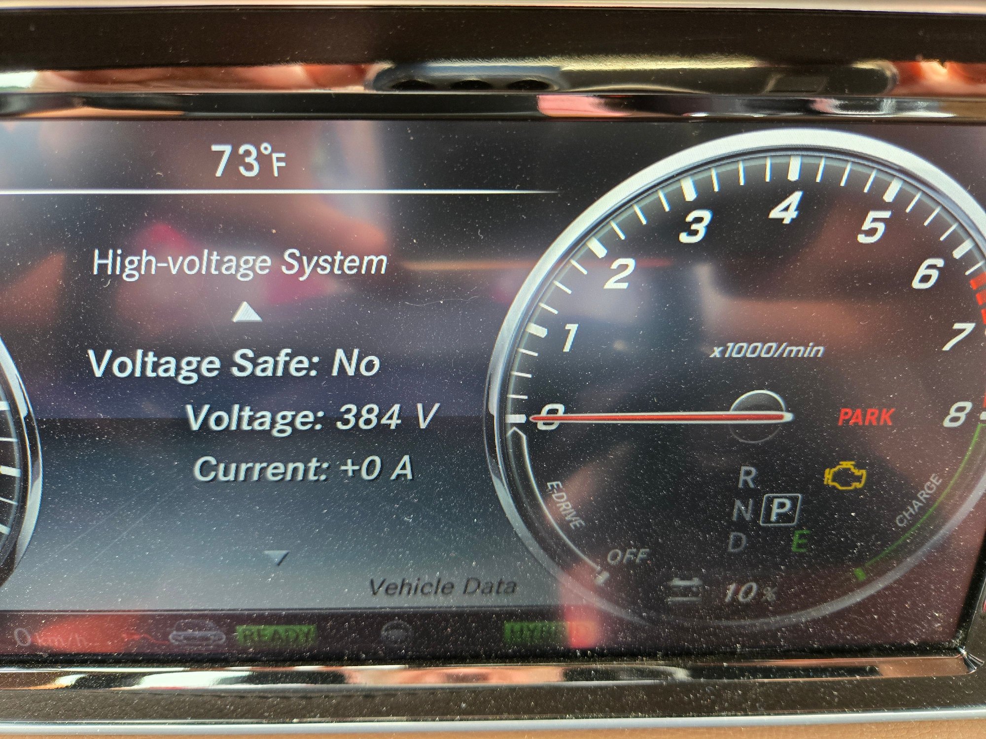

Looks like the battery is okay, here's what I get from the service menu after starting the car
You can see the check engine light is still on, but car drives & recharges fine from the engine, but will not accept a charge from the port. I suspect all either a bad connection or a bad temp sensor on the port. I cleaned up the inside connection with some contact cleaner, but can't get to the other side without taking bumper off.

I am not sure what is the normal voltage for the high voltage battery but vehicle is in accessory mode though, you mean the check engine light is still there when the engine is started?

Wait, never mind vehicle is in electric only mode of course the engine isn't running. Battery is at 10% charge though?

Yeah, since I can't charge it thru the port, I've been hovering around 10% to 20%. I can confirm it charges as I put it in 'Charge' mode yesterday and it charged the battery using the engine to 75%. Driving it today, I went all EV most of the day, and got it down to 10% which is when I took the picture.
I don't think anything is wrong with battery/drive train. I am now convinced it's the charge port itself that's bad, but need to confirm before I get myself a new one as they're not cheap and taking off the rear bumper is a chore.
