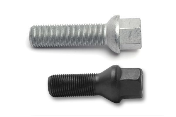

There are two types of lug bolts, a ball seat type and conical type
Since you are staying with an OEM AMG wheels, the same bolts be fine other wise after market wheels use a different wheel bolts usually conical
You would be just fine if moving from AMG wheel to AMG wheel
