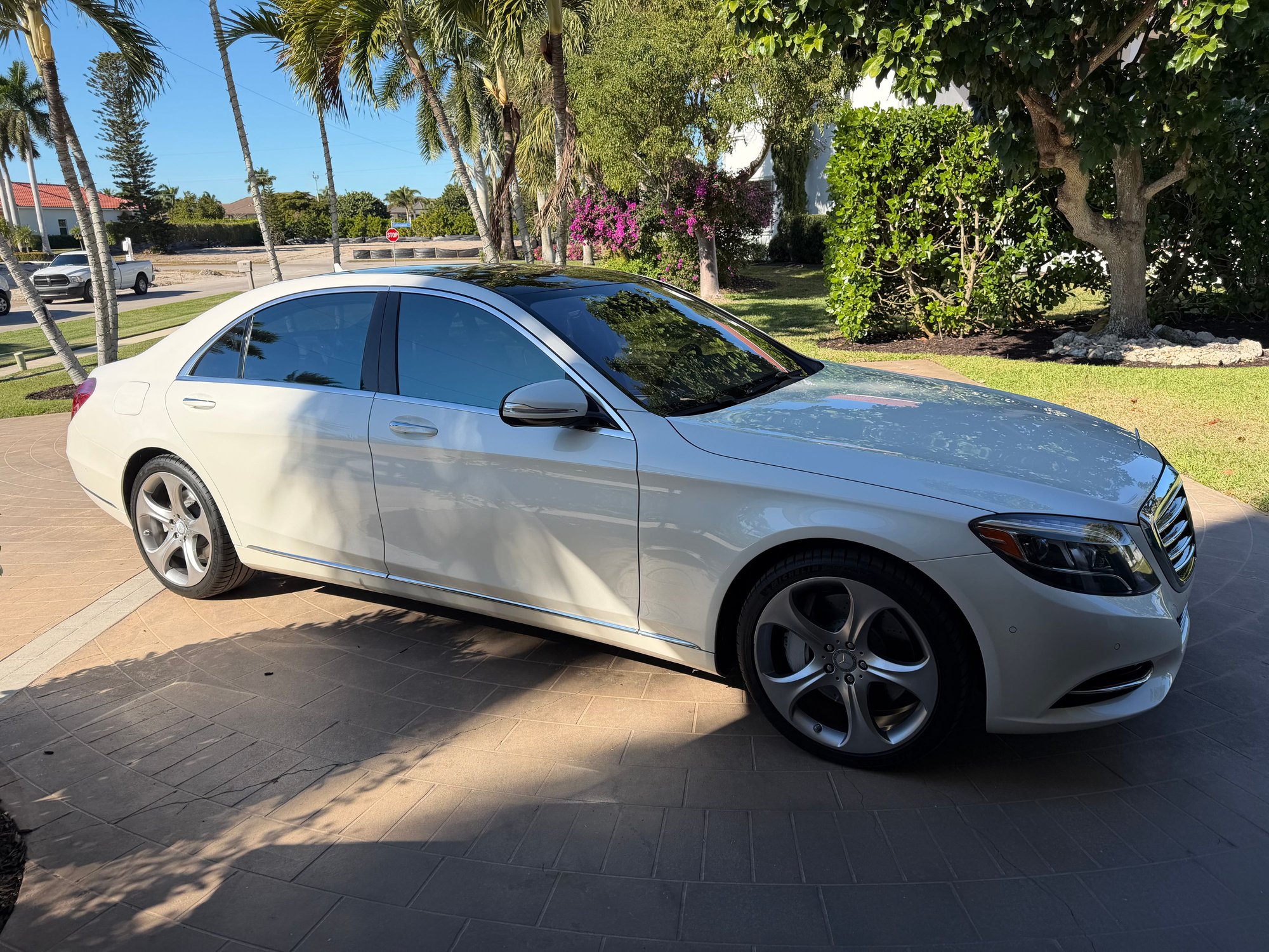

So just picked up a mint 2014 S550 with only 52,000 miles on the clock from my elderly, original owner, neighbor.
