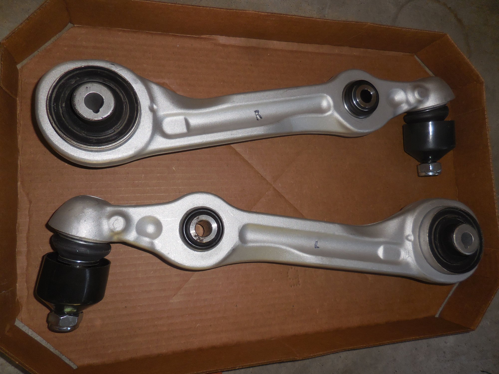

Replaced the lower front control arms on my 39k mile MBC car yesterday and what a difference! The ride is noticeably improved and steering and tracking feel like a new car. I believe what people have posted on here that ball joints and bushings in the arms wear out quickly and especially so with MBC. I was a bit surprised that the new arms altered the toe quite a bit, but the alignment took care of that.
These arms are pretty inexpensive and readily available in the aftermarket. I had bought a set for my previous Airmatic car, so I just added the 'spring arms' for MBC struts. As I result I have a pair of new unused Airmatic RWD spring arms that need a new home; if anyone would like them, just give a PM ...
