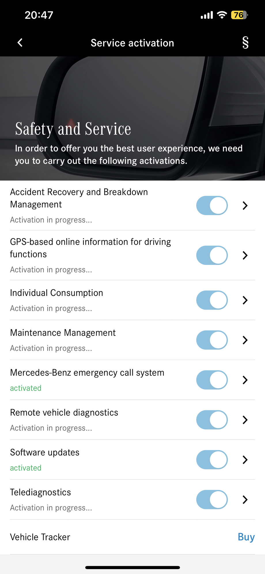

Yes i understand the services, car is new, sort of, I got it in May of 2022, everything worked fine at first, all services were activated and worked fine. in July connectivity would drop off after a couple of hours, then in Nov all remote services like, starting the car, unlocking windows etc stopped 100%. All services are good until 2025, but none of them work right now because the internet connection is not working both ways. I can update my profile information on my PC while logged into mercedes me connect and it will update the app on my phone and it will even update the email address on my car. but all the services are still trying to load, show activation in progress. MB service centers keep reloading the app and trying to re-activate all the services, but ends up doing same thing. when in car and i say "hey mercedes" it answers and says what can i do for you. I then ask for current weather conditions and it says can't do that right now, no internet connection available. when trying to do other functions, same statement comes up on car LCD, no internet connection. I see in this thread that other user had his esim chip re-programed remotely from MB and it fixed his problem, wondering if I need to have the same thing done? mercedes me connect app account has been deleted and re-done by MB service center numerous times, with no fix. They keep thinking its the app or something online, I'm pretty sure it is the car and something wrong, broke, chip messed up, software scrambled, hardware or software issue with the car. my car is an AMG CLS 53, year 2022
Finally got a MB Service Center that would listen to the problem I had and stop messing with the app on my phone. I asked them to check out the car software and chip programming to see if one or both needed to be re-programmed. They came and picked up my car, had it for about three hours and then returned it to my home, fixed. The invoice said they re-programmed the control unit, pretty vague, but whatever they re-programmed fixed the problem. All services restored; still unable to make an internet connection, but I think that has to do with me being in South Korea. I think they have that locked out. Attached is the invoice and what they did to the car, in Hangul.

Has it been fixed since? I'm in a very similar situation right now. My vehicle was purchased in Australia and Mercedes Me was activated and was working flawlessly over there.
Then I took the vehicle to Japan and now there's no internet connection, so I can't use Mercedes Me app to check vehicle status (lock/unlock, open/close windows, remote engine start, etc.)
I logged into Mercedes me portal and updated the country to Japan, accepted their terms of conditions, but some services such as Online Map Update and Local Search are still activation in progress.
Others such as remote locking are activated but my vehicle has no internet connection in Japan, so all these Mercedes me features can't be used. Since Mercedes states that Mercedes me works across countries and regions as long as Mercedes me is offered in that country, one would assume that the internet connection would also carry over automatically but apparently that's not the case, and most likely Hermes Communication module needs to be reset or updated.
