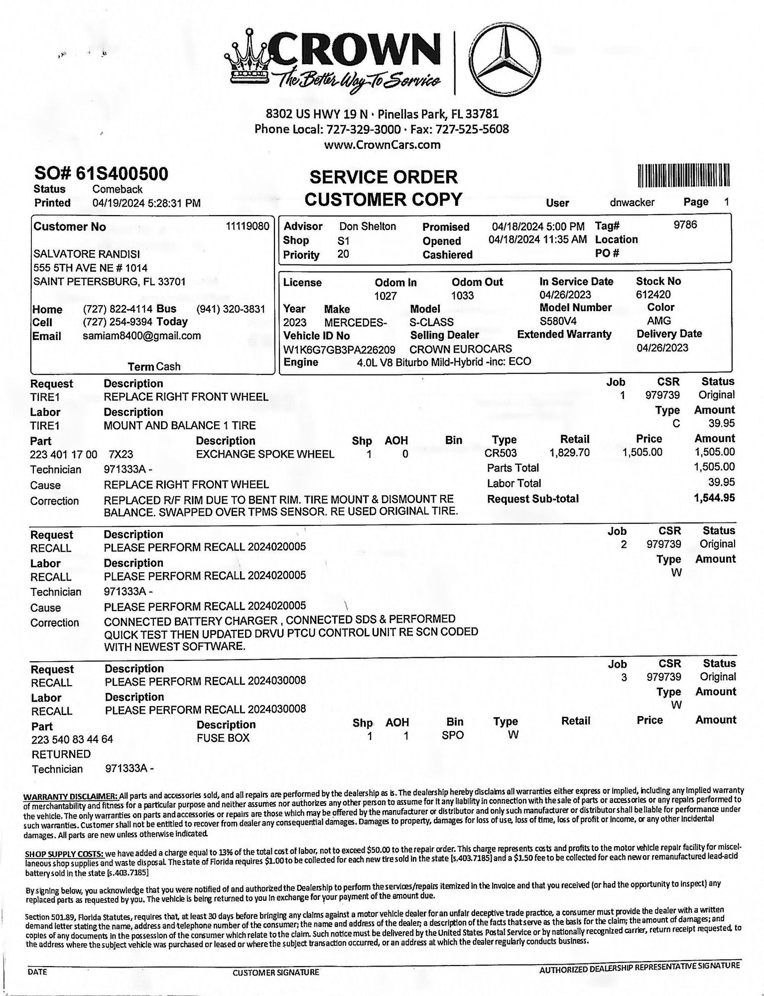

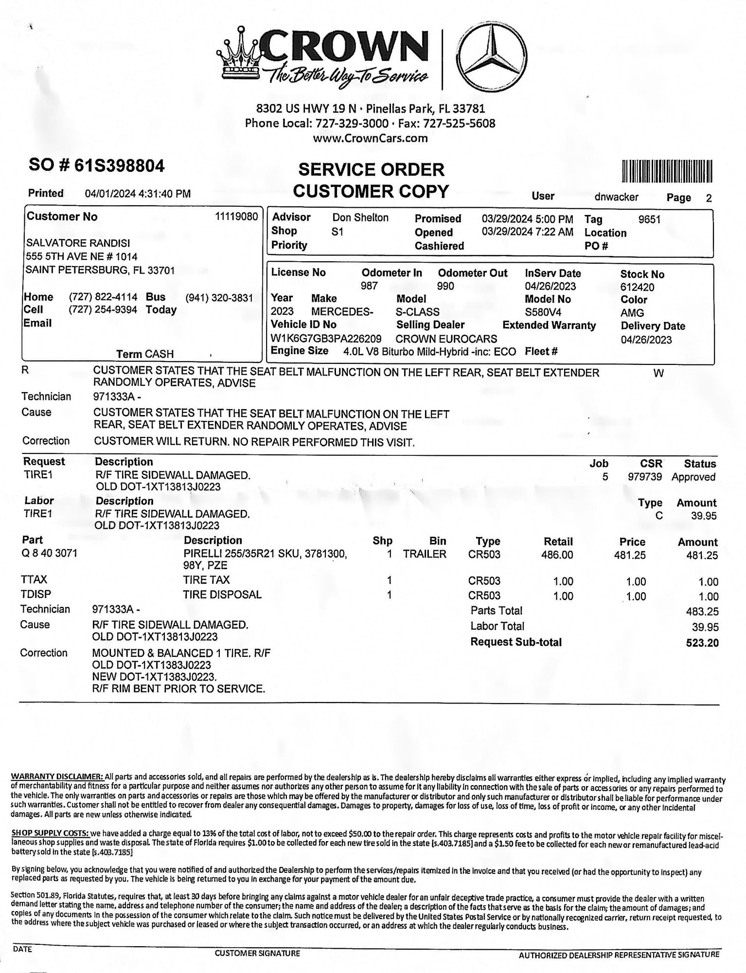

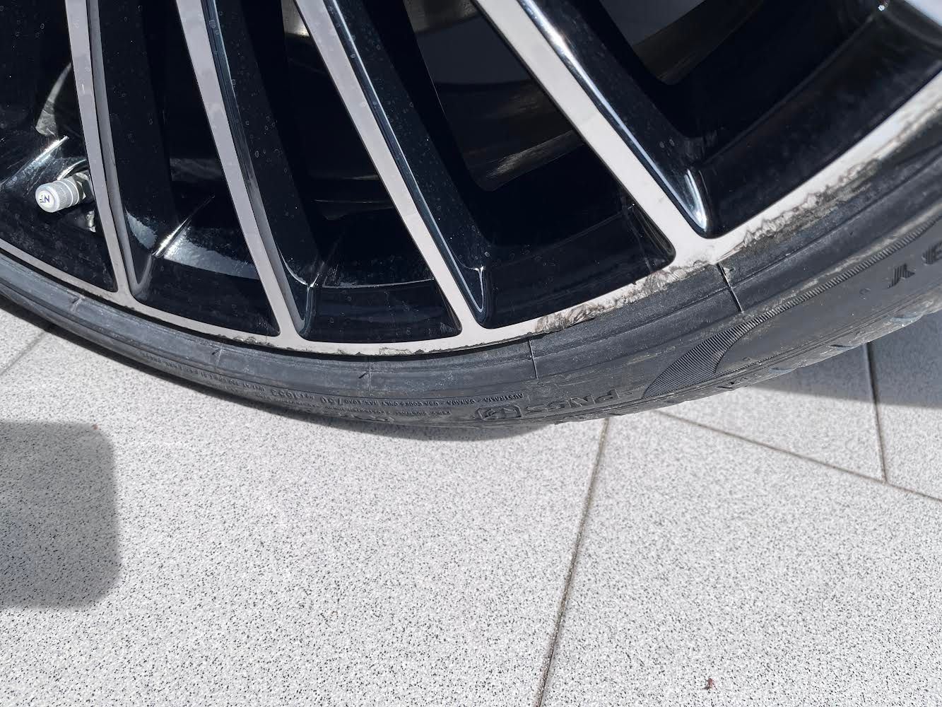

Old Sep 13, 2024 | 08:31 AM
  #42
samiam8400's Avatar
Joined: Sep 2024
Two tires in 4 months
Yes I am on my second tire in 4 months and only 1800 miles. The first was a pothole but this one is unexplained. Sitting at the light and it lost all of its air. Found that air was coming out of the side wall as fast as it was being put in. Definitely something wrong with these tires.
QUOTE=odesskiy;8596132]Seems like we have quite a few people with multiple tire blowouts. I would like to compile a list of people and data and start a conversation with MB Corporate. I have contact info for a lady in Customer Advocacy.
I will ask for one of the following remuneration options for those on the list:
a) For those that did not have rim/tire hazard insurance, full reimbursement for all amounts spent to replace failed tires.
b) For those that paid out of pocket to replace OEM Pirelli tires with Michelin tires after having at least one Pirelli tire failure, full reimbursement for the entire set.
c) For those that want to replace their 21” wheels, a refund of the cost of the 21” wheel option ($1900) and replacement with a full set of base 19” wheels and tires or optional 20” wheels and tires and refund of the price difference ($1900 - $850).
If you see another option that I missed, please let me know.
The bigger the list that we can put together, the better our chances of them listening. If interested please send me the following information to odessit12 at gmail.com:
VIN number and registered owner of the vehicle
Date and location of each occurrence
Receipts from dealer service to replace failed tire(s)
Receipts for purchasing Michelin tires out of pocket if you’ve done so.
Mercedes is using substandard tires with high failure rate and we are entitled to have the situation addressed and resolved. Tire failures can lead to accidents and loss of life and limb. Let’s make our voices heard![/QUOTE]
Old Sep 13, 2024 | 08:50 AM
  #43
Frenetic's Avatar
Joined: Jun 2019
Posts: 2,140
Likes: 945
From: Costco
2023 S500
It looks like you curbed your wheel and tire and maybe that caused the air leak? Did they just replace the tire and not the wheel/rim? I’m wondering if it will leak again or if the leak was caused mostly by the tire getting curbed and not a result of the wheel damage.
[/QUOTE]
Old Sep 13, 2024 | 08:59 AM
  #44
samiam8400's Avatar
Joined: Sep 2024
Nope that was from the pothole. The second one is on a brand new rim and has no apparent damage to the tire.
