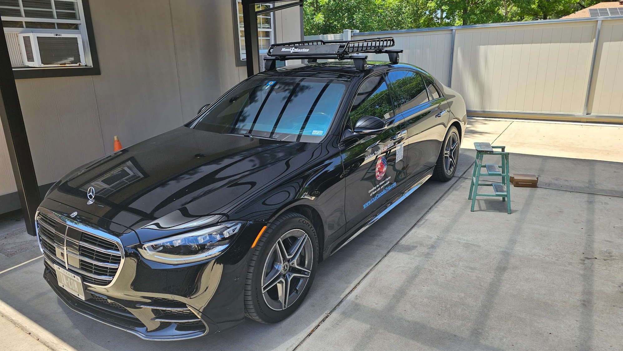

Hi Everyone.
Managed to install a generic ROOF RACK and CAGE on the S580.
This is for the HIDDEN TRAILS part 2 coming up in August.
STARLINK mobility dish will be installed in the CAGE.
Does anyone know which FUSE controls the PANORAMIC SUNROOF?
I want to disable it for the duration of the road trip.
