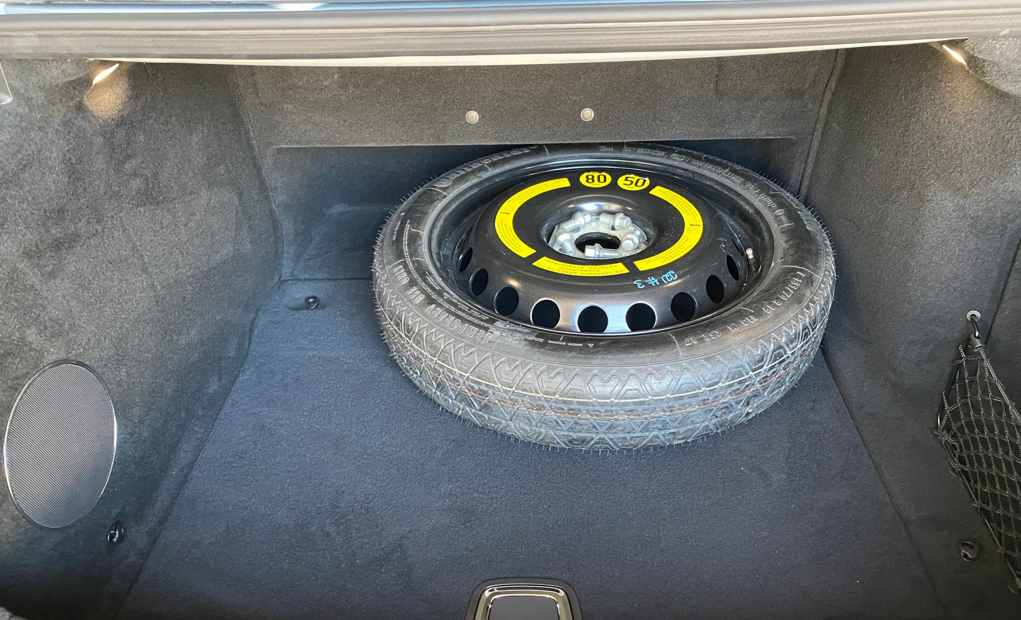

Hi everyone
Was looking to purchase a small spare wheel for my next 12000 mile road trip. Found these 2 items that are NOT FROM MBUSA, and am hesitant to order, not knowing if they will be a good fit for the vehicle. Has anyone had any experience with purchasing a donut spare wheel for their S580?

You keep asking for advice on this and that, which is fine. I’m pretty much outspoken on the whole “no spare/run flat tire” subject and feel very strongly that not equipping EVERY passenger vehicle with a spare is lunacy. That said, my opinion is that doing what you are doing, in the vehicle you are using is also LUNACY! Virtually every issue or obstacle you have asked for advice on, could have been avoided by using a vehicle that was much better suited for this adventure of yours. It would have made the trek that much easier—in my opinion. Using an S Class certainly can be done, but the question is SHOULD it be?
The biggest concern for a non-specific W223 spare is clearing the front wheel calipers. I have a W221 compact spare that I carry in my trunk. It was fine in all of my W222’s, but it will not clear the front calipers on the W223’s. I still carry it, but if I was stranded with a flat front tire, I would put a rear wheel on the front and the spare in the rear. Best of luck to you and I’ll leave you with one last thought: RANGE ROVER!

I purchased one from EZ spare wheel. Haven’t had to use it but, a friend of mine who purchased it as well did have to use his one time and had no problems. It was a front wheel as well he had to put it on. They provide you th slug nuts and hub ring also.
