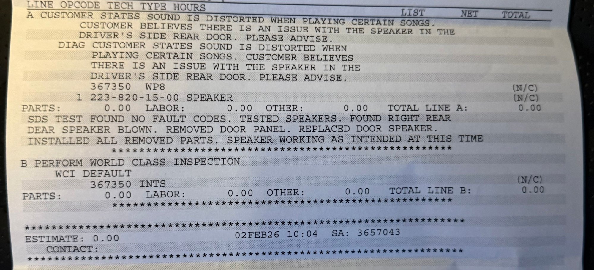

Did you end up finding out what it was. I have the exact same issue on my 2025 s580. Most the time it is fine, some songs cause a distorted sound seemingly from the driver side rear door speaker. I never dialed the volume up loud enough to have blown it. The issue is more noticeable on the burmeister 3D setting than the pure setting.

Finally had the time to take it in. Dealer confirmed blown speaker. They replaced the speaker under warranty. Being able to listen to the sound system with the 3d setting without the aggravation of crackle is phenomenal.
Which speaker was blown? The driver-side “midrange” speaker that is in the middle of the door?
Old Feb 6, 2026 | 07:48 AM
Zellybob's Avatar
Joined: Mar 2025
Posts: 7
S580
I don’t know. I’ll attach a photo of the work performed, not sure if that helps.
