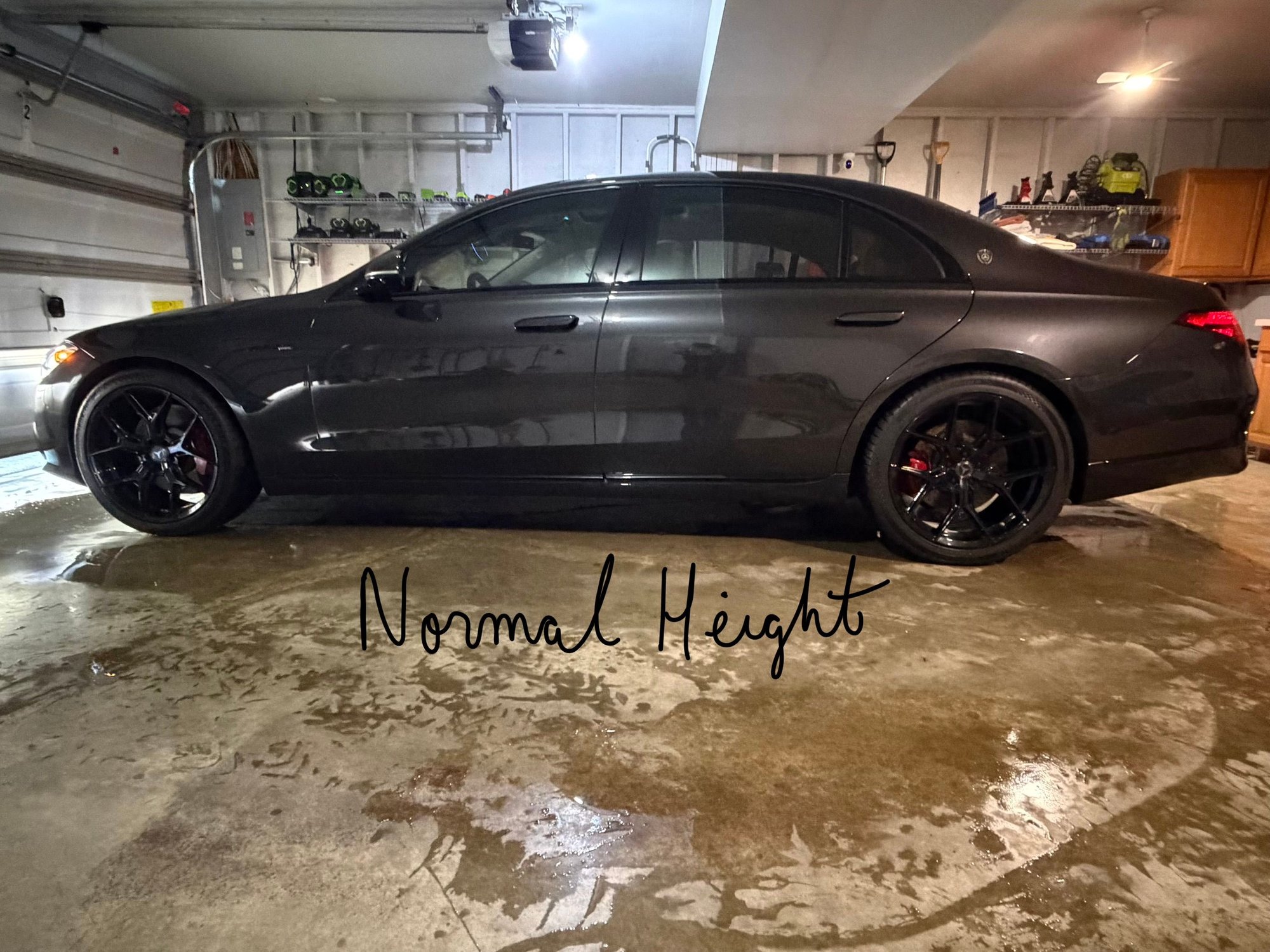

Here’s what I run: F: 265/40 R21 105Y and R: 295/35 R21 107Y
I did adjust my ghost links about 10cm higher (when the car is in sport + mode) due to the lowering of my S580 at high speeds no speedometer problem at all
u increased both width and sidewall on the std 21" tire specs😮 nice!
what tire brand/model r u running?
I'll probably stick with 20" due to the common blowouts reported on 21s (hell, even on my 20s with stick hankook i had a blowout!).
although i wonder if ur double increase on tire size entirely removes this issue on the 21s..??
also would u mind posting 3 shots of urs on the ghost links... raised, comfort and sport.
Sure; they will be labeled according to the heights in the photos.
woa...huge!😮
Old Jan 9, 2026 | 08:46 AM
nearwater4me's Avatar
Joined: Apr 2025
Posts: 490
Likes: 205
From: Lowcountry, GA
'25 S580
woa...huge!😮
Yeah, the 21" wheels with 40/35 profiles fill the wheel house nicely.
