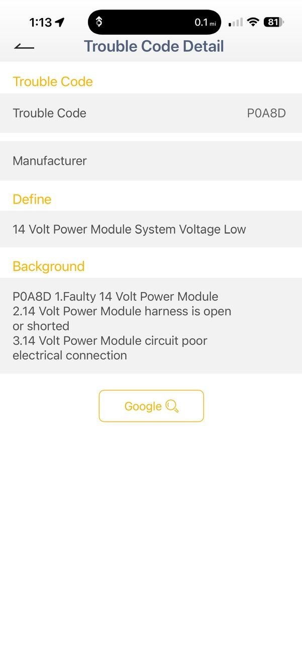

Had a CEL light come on this morning, tried to clear it with my scan tool but it wouldn't clear. It did eventually go away but this is the code

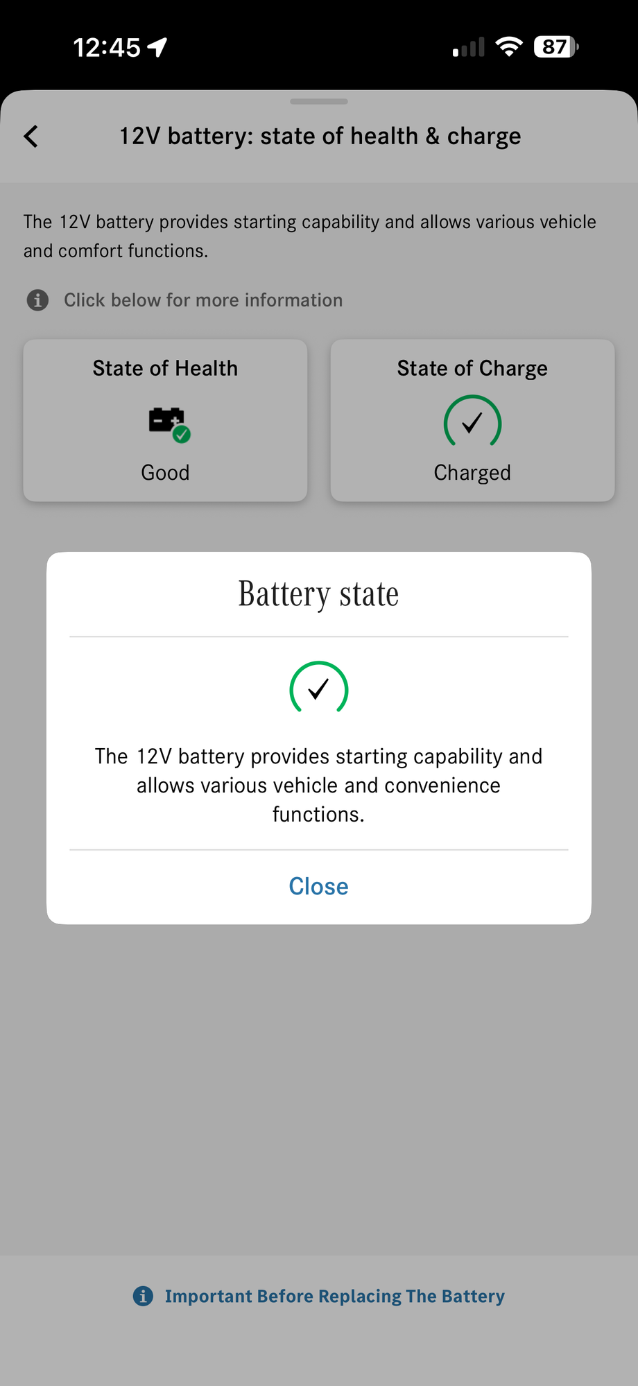

My quick Google leads me to a bad 12V battery, which I have suspected for a while. Right now parked my car is showing the battery partially charged after having gotten home from over an hour driving, so it should be charged.
Going to put it in tomorrow night for them to look at it Wednesday but wanted to see if anybody else had ever gotten this code before.

DTCs vary by manufacturer and model, so I could be completely wrong but I work on issues on EV electrical systems and there's this DTC that involves charging the 12V battery : P1A8D
It's a fault code when the LDC (Low voltage DCDC converter - basically the converter equivalent to the alternator on ICE vehicles) output path is faulty.
If there's a connection issue from the LDC (alternator in our case) to the 12V battery, and it's not charging correctly, this DTC will be triggered. (P1A8D vs. P0A8D)
I'm guessing it's the same in your case.
I think the 12V battery itself or a simple connector/harness might be the culprit. A simple fix!

What code reader are you using? I found out that mine provided incorrect descriptions that were way off versus what the repair invoice indicated.

Car is all done, apparently it was a software issue and the battery is fine. Updated the software. We’ll see. It is showing now in the app as fully charged.
