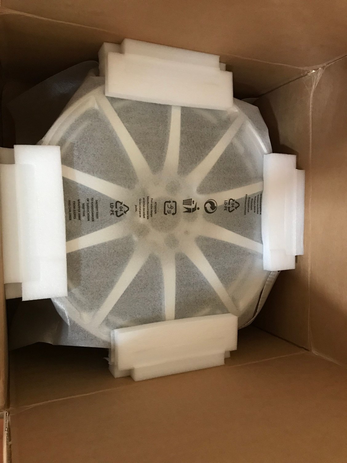

I used this company to buy ALPINA center caps for my B8 wheels. When the order arrive, they also attached documents showing how they procured the original part from ALPINA directly from Germany. This is one of very few companies that actually work directly with the same OEMs when almost all other caps I found were just chinese replicas. Would never buy something like this from ebay. Arrived in Alpina original packaging too (even the double-sided tape had Alpina logos). Very popular company on BMW forums, would definitely use this one. You always get what you pay for and I would not cheap out on something like wheels.
Old May 3, 2026 | 12:21 PM
S_W222's Avatar
Joined: Sep 2019
Posts: 3,154
Likes: 1,529
From: U.S.
Current/Last 5-years:GLS;G70;Alpina B8;X7;Accord. Sold:X7,TeslaS;S560;S550,X5;530e;L.Navigator;LS460
Originally Posted by S_W222
I used this company to buy ALPINA center caps for my B8 wheels. When the order arrive, they also attached documents showing how they procured the original part from ALPINA directly from Germany. This is one of very few companies that actually work directly with the same OEMs. Almost all others are just chinese replicas. Never buy something like this from ebay. Arrived in Alpina original packaging too. Very popular company on BMW forums, would definitely use this one. You always get what you pay for.
​​​​​​​How the order came...
