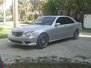

They fit, with some work.
I got the rims mounted, but not without some minor work.
They are supplied at 35 offset. With 285s on the rear, that rubs.
I cut 4mm off the mount pad on the rim, and now they are almost perfect. I think I need to cut a little to tuck the fronts under the wheel wells (but they run fine with 255s at 35 offset).
