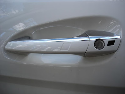

if you can lock your car by by touching the square impresion on your door handles, you have keyless go and you are just missing the start button. so keep using it and enjoy.
http://lh4.ggpht.com/peabers/R4Uqq9Z...DoorHandle.jpg
