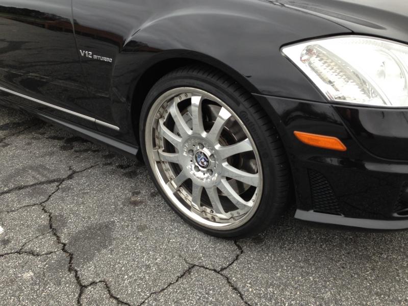

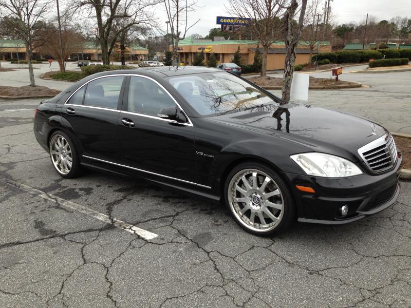

Has anyone tried fitting a 275/30-21 on the front of the S-class?
21" tire selection is a bit limited. The next smallest size is 245/35-21 and it is a little stretched on the front rim (Carlsson Ultra-lights 21x9). I tried a 265/35-21 and it rubbed the upper control arm badly.

W221 Front tire fitment update
Just an update. Fitted a set of Continentals in 275/30-21 to the front of my 2007 S65, and they work perfectly. So....just for information sake, you CAN fit a 275/30-21 to the FRONT without any clearance issues. Wheels are Carlsson 2/11 ultralites 21x9 with 40mm offset.

Please excuse the cellphone pics.
Attached Thumbnails Big front tires?-side-close-275-front.jpg   Big front tires?-side-275-front.jpg
