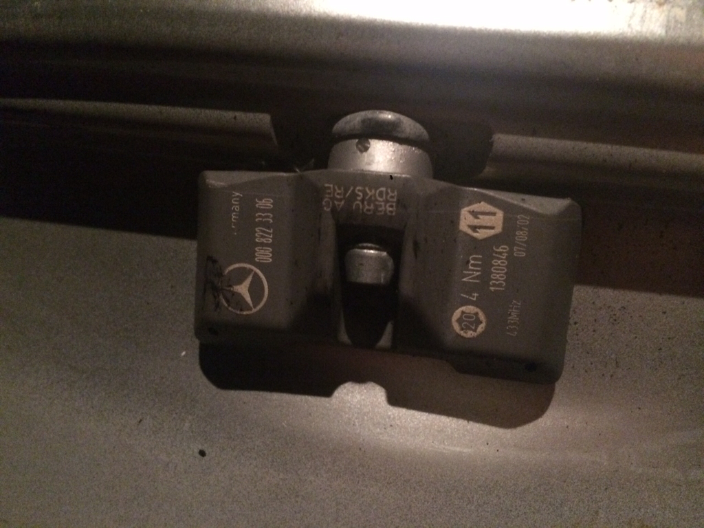

Over the next week I am having 4 new tyres fitted and the wheels refurbished on my AMG.
It has factory fitted TPMS fitted, however all four have been dead for a few years(batteries).
Mercedes want £105 each for each sensor. Is there a cheaper equivalent?
Attached are photos of the original ones on my alloy, I notice the Audi/Volkswagen have the same frequency and shape, and are £50 each new!
eBay link: http://www.ebay.co.uk/itm/3710014448...%3AMEBIDX%3AIT
Looks exactly like my existing ones:
I don't really want to gamble £200 for it not to work. Does anyone know if they will work?
