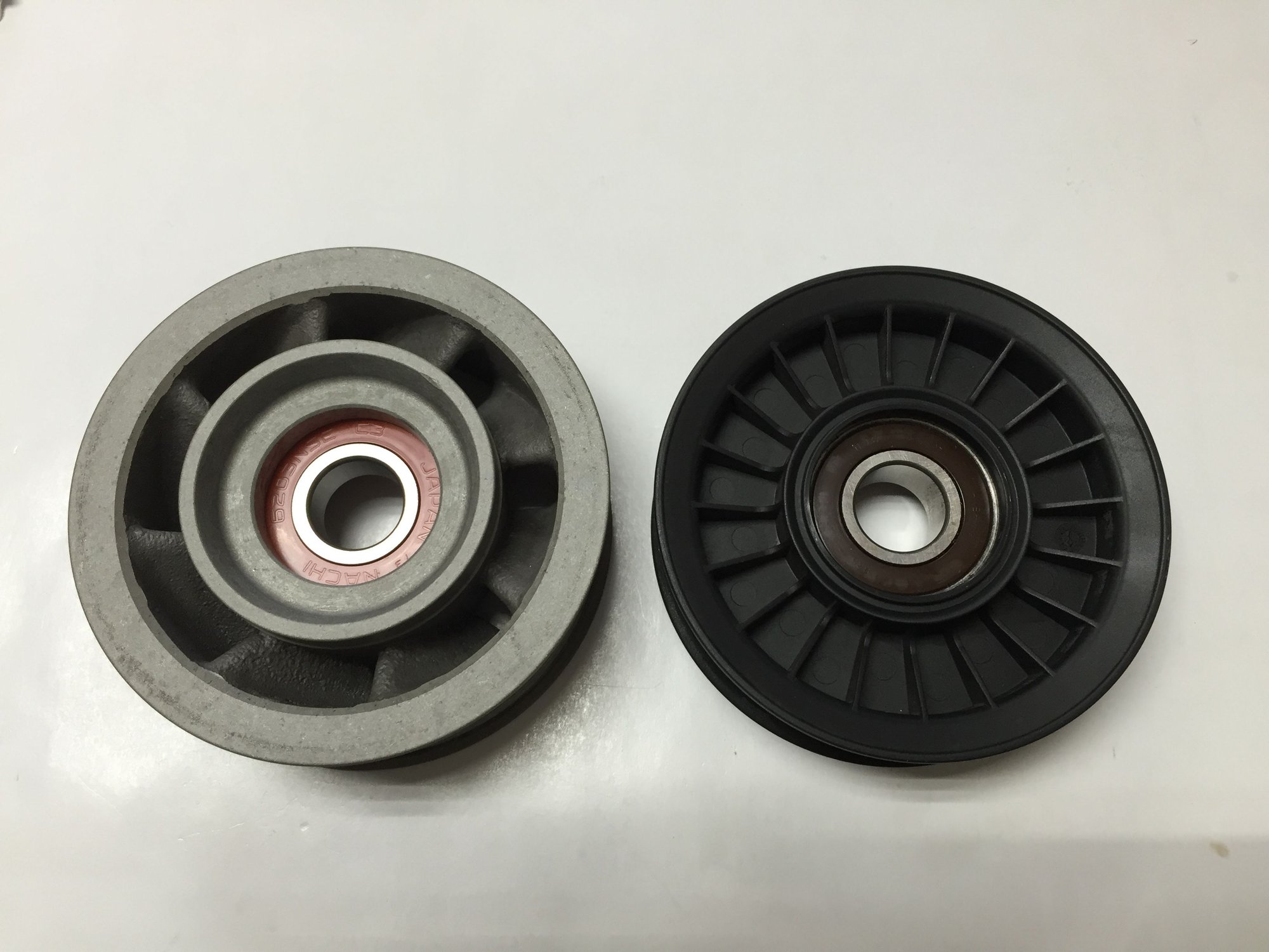

I want to replace the bear on double idler pulley.
I already replaced bearing for supercharger idler pulley (left metal pulley in the picture), but I can't figure the right one (plastic one).
There is no o-ring or snapped-in piece as I can see.
Anyone replaced this one?

Replace it with a new Dayco. See if this thread will help:
https://mbworld.org/forums/w211-amg/...uild-27-a.html
Dayco 89130 should be the proper pulley. I used a Dayco 89012 pulley but had to sand down one side for proper clearance.

Thank you for great info!
