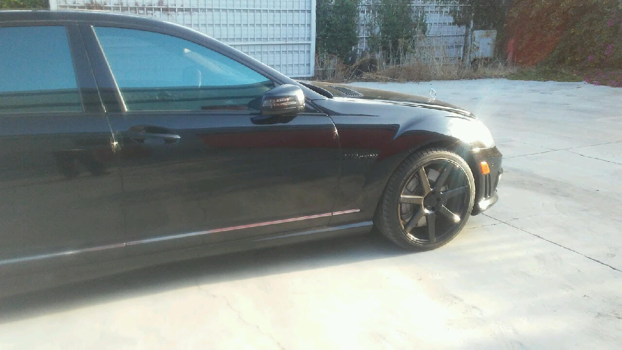

Are those solid rotors?

they are vented rotors on there .pics I take suck but ill get a close one for you buddy.

I only asked because one of your photos shows the front rotor pretty well, and it looked solid to me. No holes or slots. But, then again, could just be a low quality image that didn't pick up the detail. Nice looking ride BTW.

ur right bro the front ones are solid and rear are vented.i changed a rear tire n seen vented so I just assumed all were. do u know if that's cool or should I swap out asap? don't want to risk other components to excessive heat if it will damage them u know .ur input has is always helpful thanx again

Previous owner probably replaced the front rotors at some time with a lower cost alternative that wasn't vented. Personally, I'd leave it alone for now if they're still in spec for thickness. Once they're worn, then go ahead and replace with vented discs if you so choose.
Vented rotors are really designed to help prevent fade once hot. They're not really useful for normal day to day driving. Unless you're tracking your 221, I wouldn't be worried about premature brake component failure.
