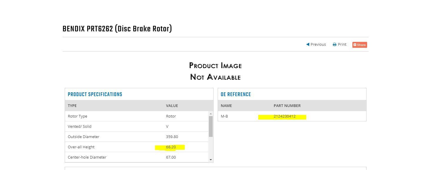

Wondering how this could happen as I double checked with the Bendix website and it still lists it as a fitment for W221 S63.

When reviewing the Bendix site, the giveaways are the rotor dimensions and OE cross reference. I know the 221 AMG disc hat height is ~10mm shallower than the 212 therefore they are mistaken in adding 221 apps on the product. I am unaware of an aftermarket solution however when looking for an aftermarket product, use the OE cross reference 2214230812. My assumption is all manufacturers/vendors are reboxing the OE part.
