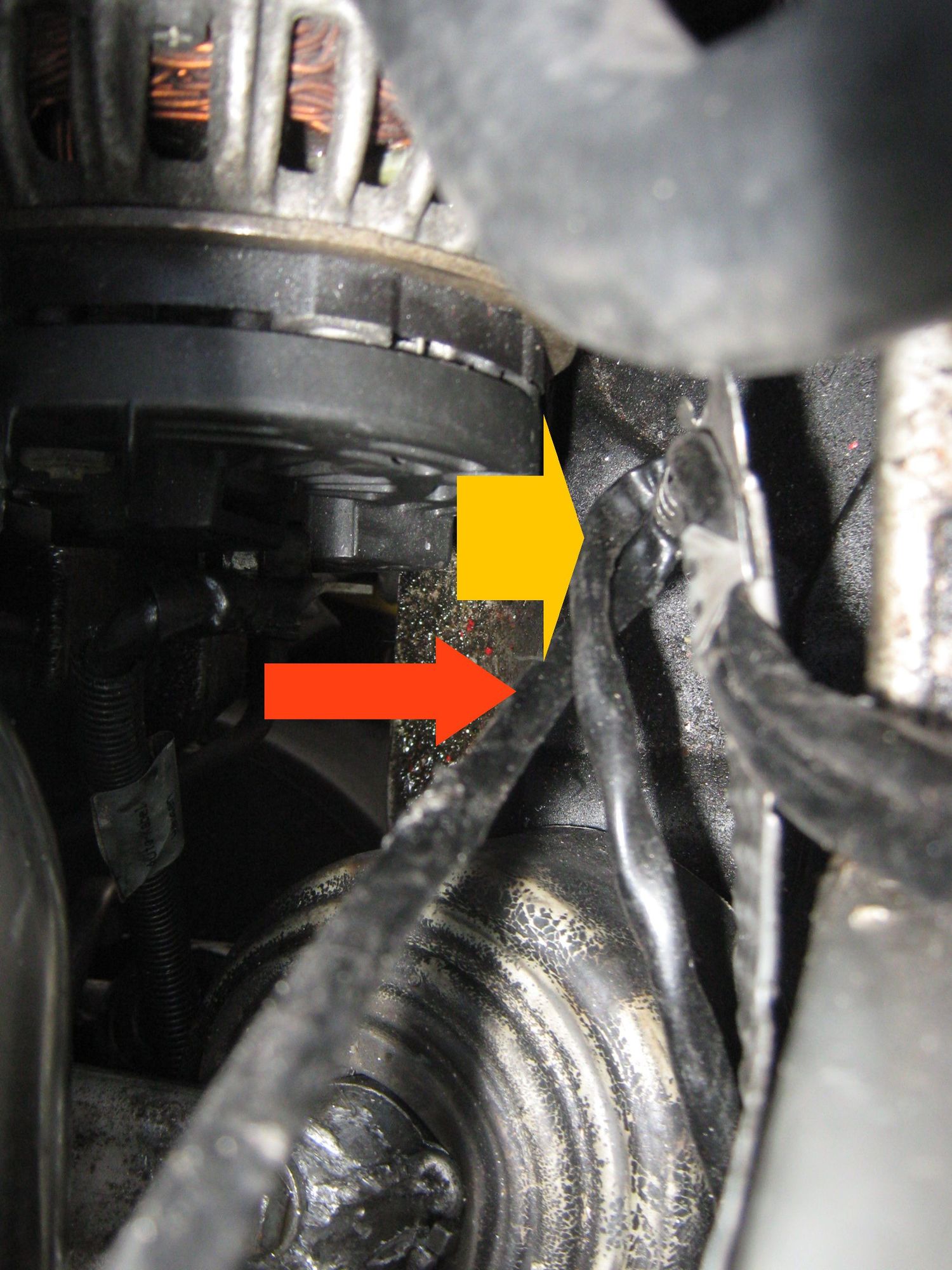

There is a lead that runs from the inner wing, down behind the coolant reservoir, to just behind the alternator, this splits into two leads, one, I think, goes to the cylinder block for the coolant temp sensor, the other one is the problem.

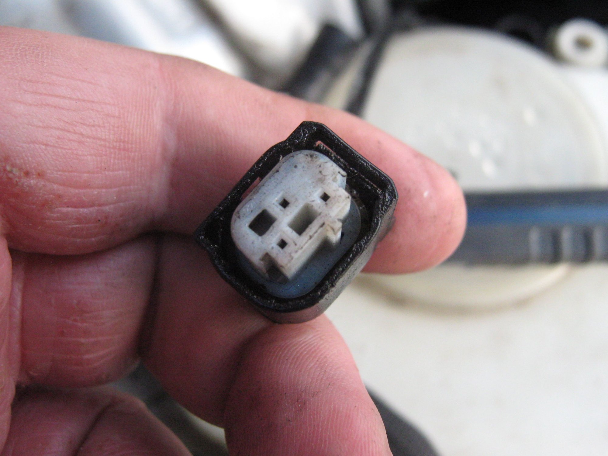

It is a three lead plug, the wires are:
Blue/Green
Blue/Yellow
Yellow/Green
(Where the first colour is the primary colour, and the second colour is a stripe)
The first photo is wher the lead runs from:
The yellow arrow points to the lead that runs to the block, the red arrow points to the mystery lead, and you can see where it runs down the inner wing.
This is the plug on the end of the lead:
So far, I have tried the Engine oil level sensor, the steering solonoid, and the MAP sensor, all have their plugs in them.
The lead will only reach the right hand side of the engine, so it isnt the crankshaft sensor, or anything on that side.
It will reach maybe as far as the outer edge of the crank pully.
If anyone knows where this lead should be plugged in, or anyone who has an S55 would kindly have a look see if they can see where it goes to, then I would greatly appreciate it.

ABC Pressure sensor, runs near the rear of engine, pressure sensor is on the distribution block with the pulsation damper.
Old Apr 7, 2019 | 04:01 PM
steveskeggy's Avatar
Joined: Apr 2019
s55 amg
That would explain why I can't find where it goes, as I swapped my ABC for Strutmasters before I started on the engine.
Thanks for that, been driving me nuts.
