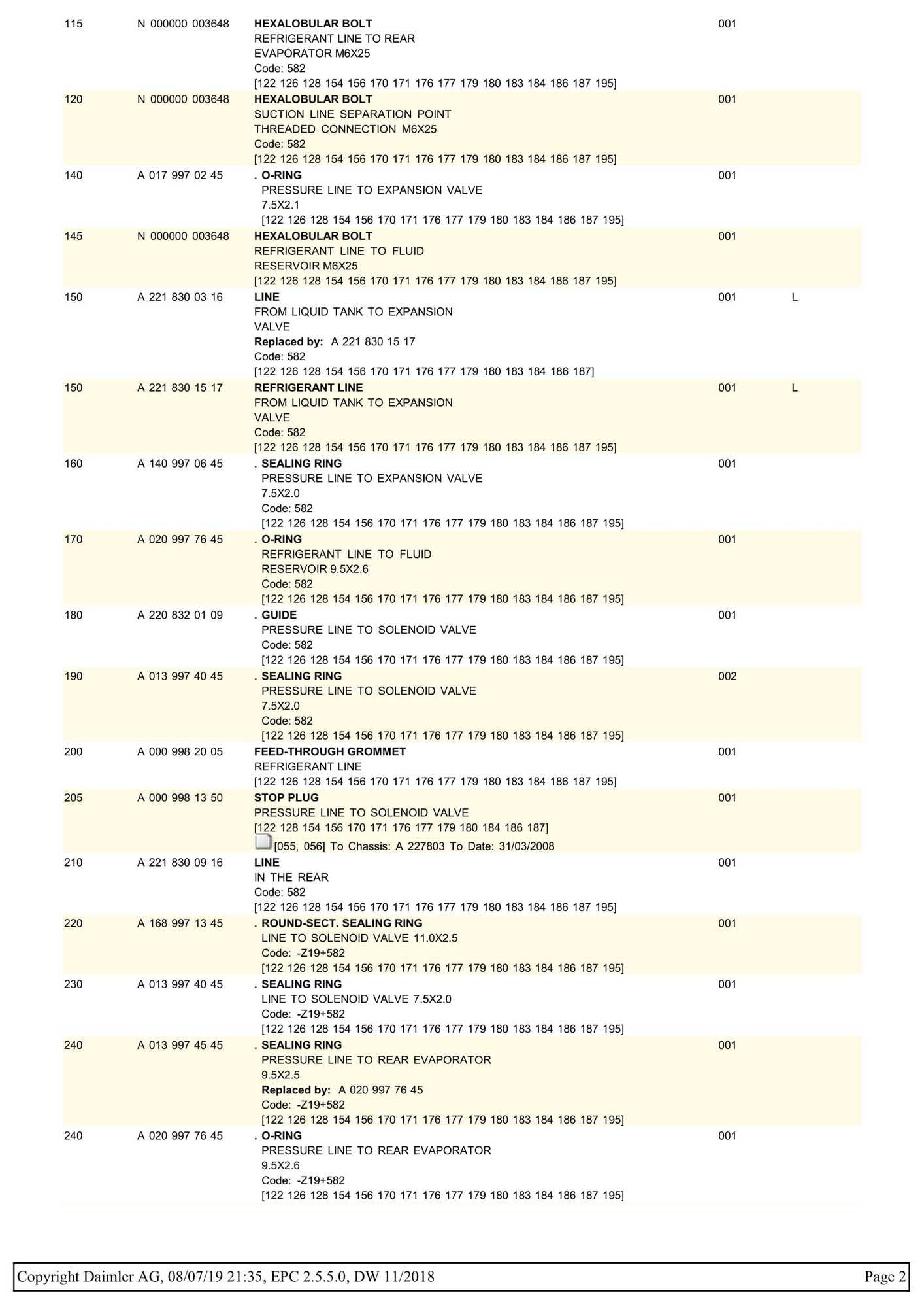

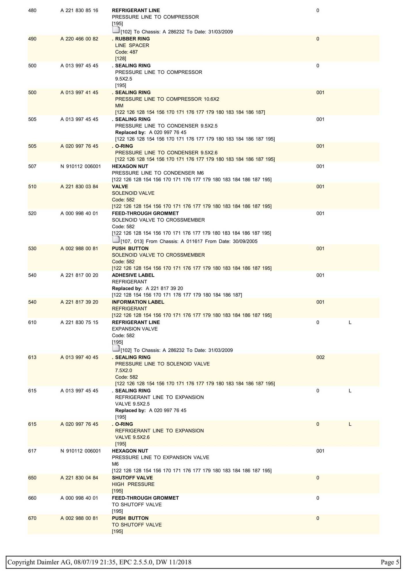

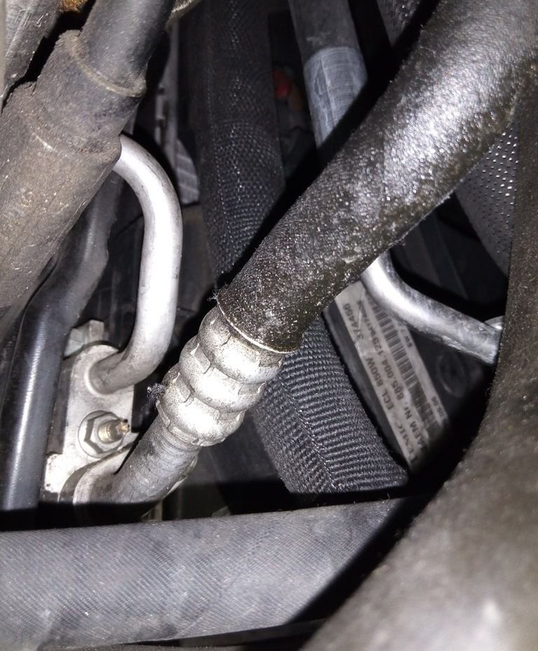

High side A/C hose.
A/C blows cold? Clean the hose with brakecleaner real well. Check later for if it is oily again.

You guys nailed the location
Originally Posted by JohnLane
High side A/C hose.
This is the current plan
Originally Posted by pmercury
Did he he mention that he had a leak ?
High side A/C hose.
wow, you are good in reading the doc I posted
Makes no sense, AC contains gaz and oil. Any refill station has free diagnostic

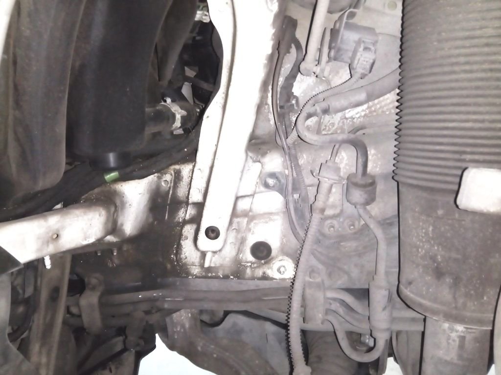

There is no leak and the AC is blowing cold in the Texas heat.
I removed/replaced the DS front fender liner (the old one was damaged) and from that vantage point I could see some oil on (coming from) what appears to be a black plastic cover in the engine bay.
So for now I believe this is the source that I need to keep an eye on before I pull anything apart as at this stage it looks like a minor issue.
I appreciate your guys feed back and time spend on this.
I just acquired this car and from a under need inspection on my lift it's the only area that shows a small fluid leak.
