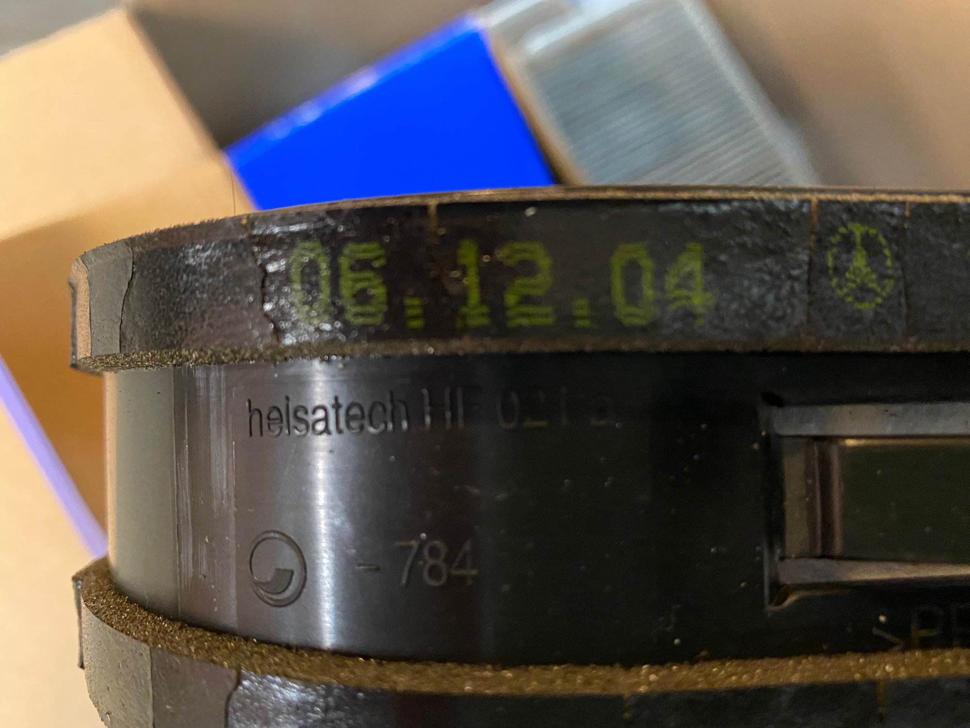

Cabin air filters, please change them.
These were changed in 2008 as the MB service history states.
These are the original charcoal filters.
Full of debris, leaves etc..

Yes, people, it’s not rocket science. Replace your prefilter and the charcoal filter.
Pull back passenger footwell carpet (right side in N. America). remove glovebox door using simple tools and brain, replace filters, put glove box and flip carpeting back.
It’s the same procedure as a Jeep Grand Cherokee and Toyota Laid Cruiser. Don’t be afraid to maintain your Mercedes. You can do it!
