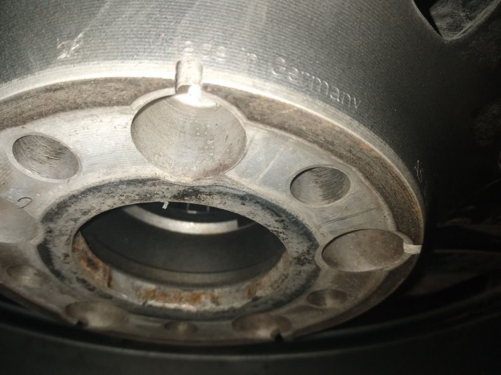

Hi everyone, recently joined as I am looking at acquiring my dream car (a W221 s550). I've always loved the look of the OEM S63 rims and found a pair near my hometown I'd like to buy, but am not sure if they are genuine.
They seem to have the right profile, but look shinier than all other s63 rims. Product codes match a set made by Fuchs. Could your experienced eyes lend any feedback?
Thanks in advance, here are the listings details:
Set of 4 20" forged staggered genuine stock factory alloy rims wheels off 2008 - 2009 Mercedes AMG S-Class S63 and will fit other model and years as well.
The rims are in perfect like new condition, guaranteed straight and completed with center caps.
They are high quality rims made in Germany.
Type 221.
They are staggered rims
Part number: 35946 and 35947 Wheel diameter: 20" Front 20x8.5 Rear 20x9.5 Center bore: 66.56 Bolt pattern: 5x112 Offset: 43

Have them send you a pic of the inside of the wheels with the part numbers/wheels sizes and it would also be stamped "made in germany"

The size and offset is correct
The finish does not appear to be original unless they have been re-worked any after market wheels I have seen so far don't have the ET43 offset
Hereby the specs of my S65 wheels

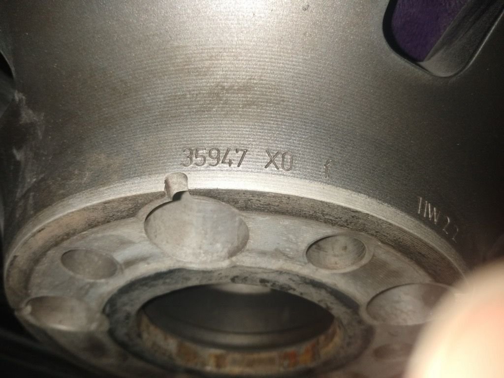

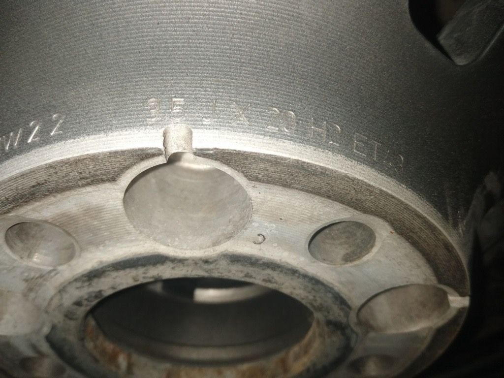

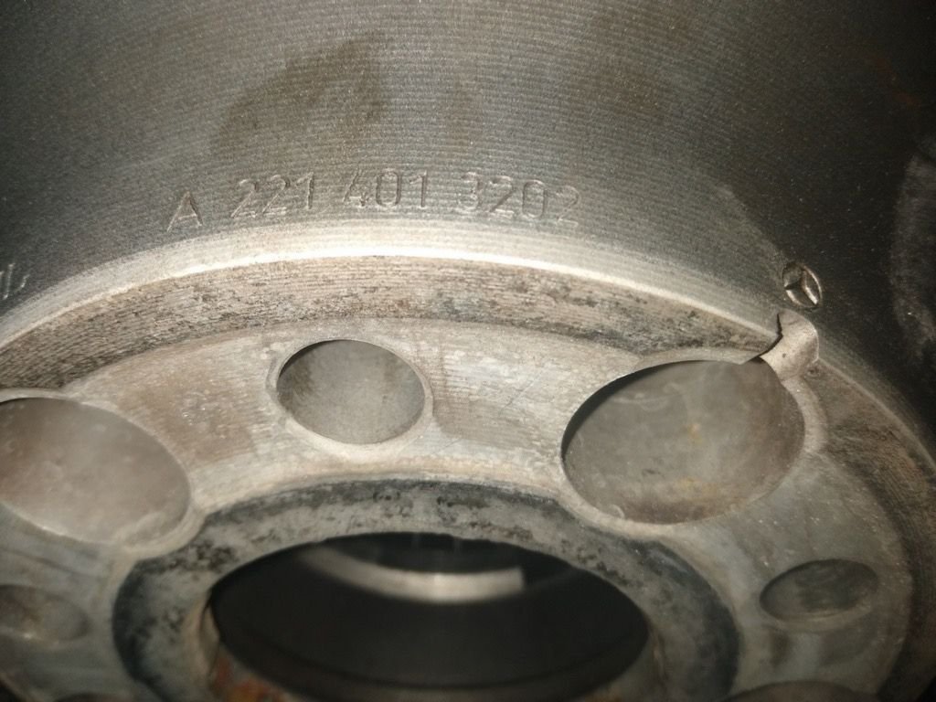

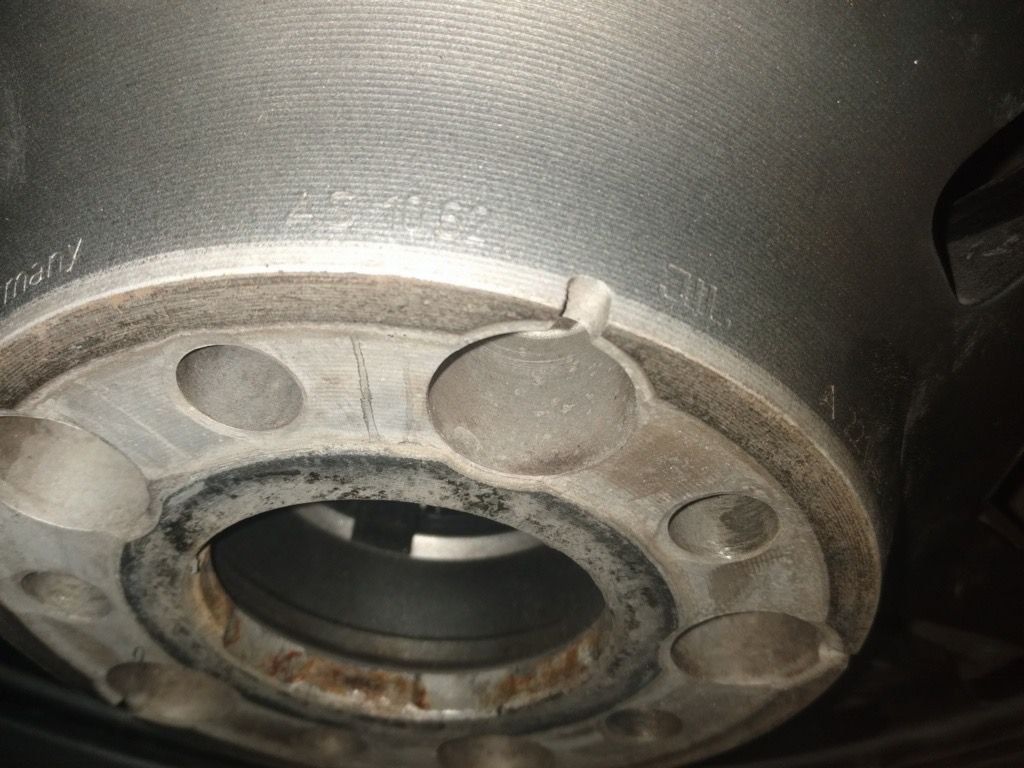

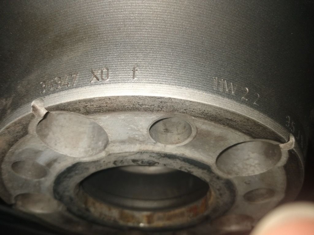

Thanks for the replies, they do seem to have a shiner finish than yours (nice wheels btw). Here are pictures of the inside barrel, seems oem quality.
