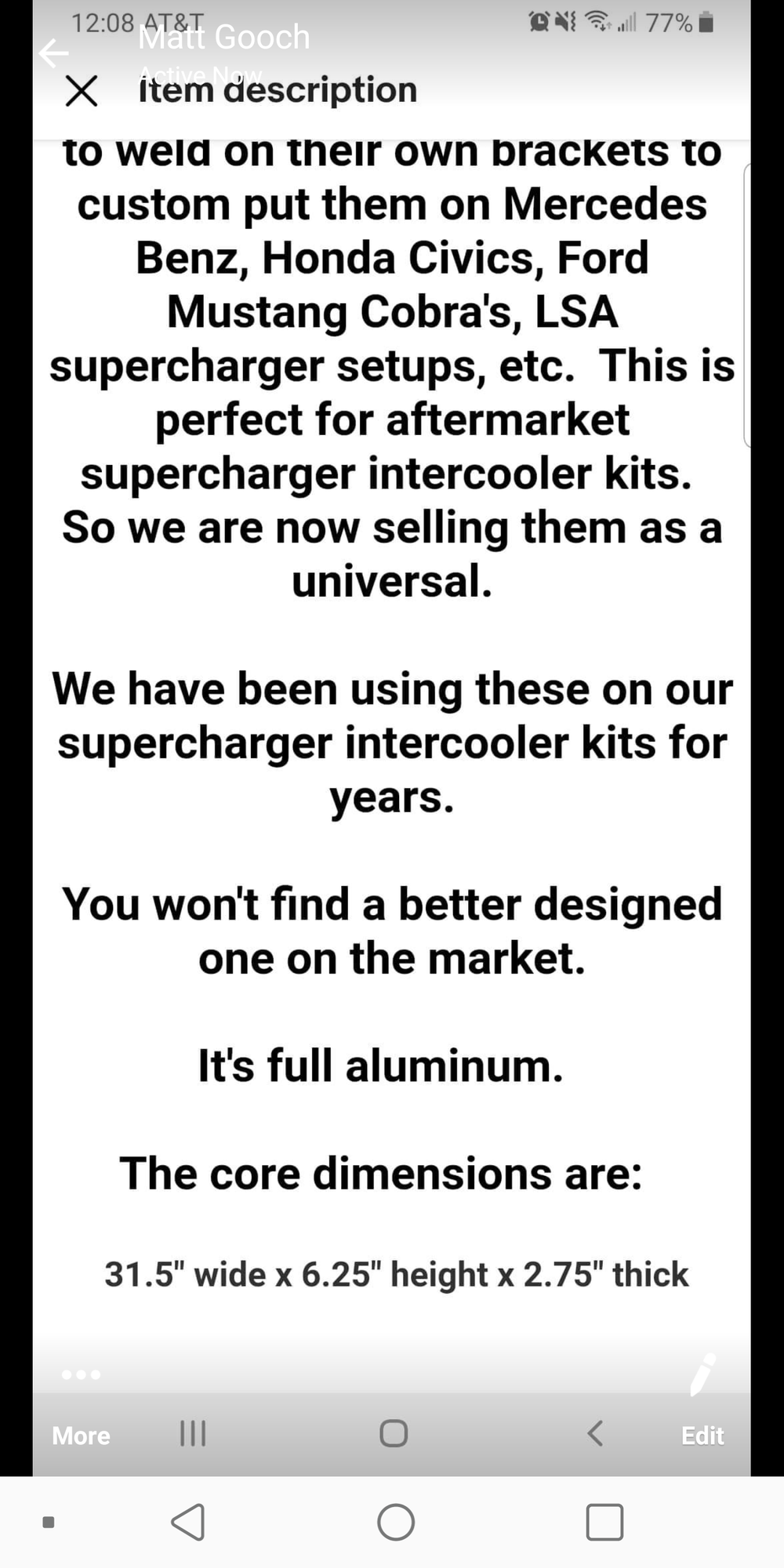

Do you have a source for the HE? Maybe even dimensions? I am not trying to buy one from EC, only to modify it. Rather have something straight bolt on
Old Jun 7, 2020 | 06:50 PM
Budget Audio's Avatar
Joined: Apr 2019
Posts: 27
2006 S55
no source but this is what my guy sent
