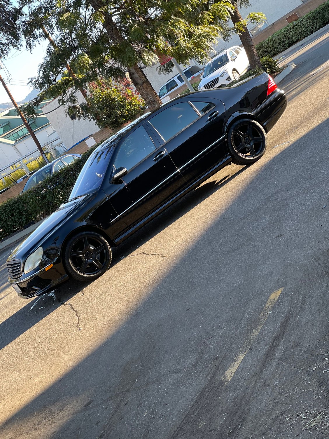

2003 s430 how to make the exhaust sound aggressive
Hello I have a 2003 s430. Can I put 2003 s55 AMG mufflers on my car?
thank you..
I live in Los Angeles area
