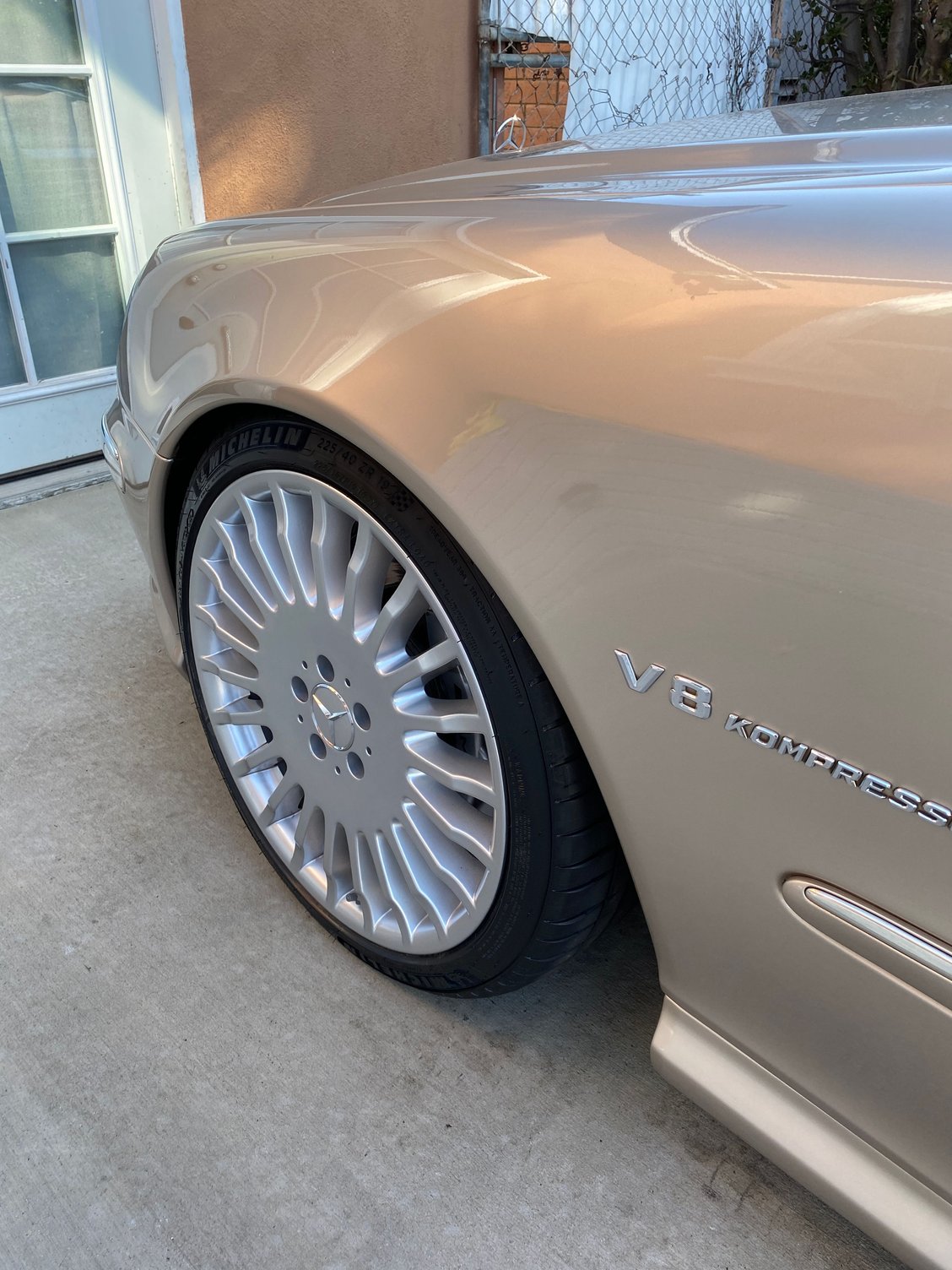

Wheels are back from refinish and Michelin PS4S are on, lowered to "PARKING" height with lowering links
Yes, there is spacers, 12mm.
I wanted a fitted look, and to be able to get the car low. So this was my path. If it's not for you, THAT'S OK too. To each their own

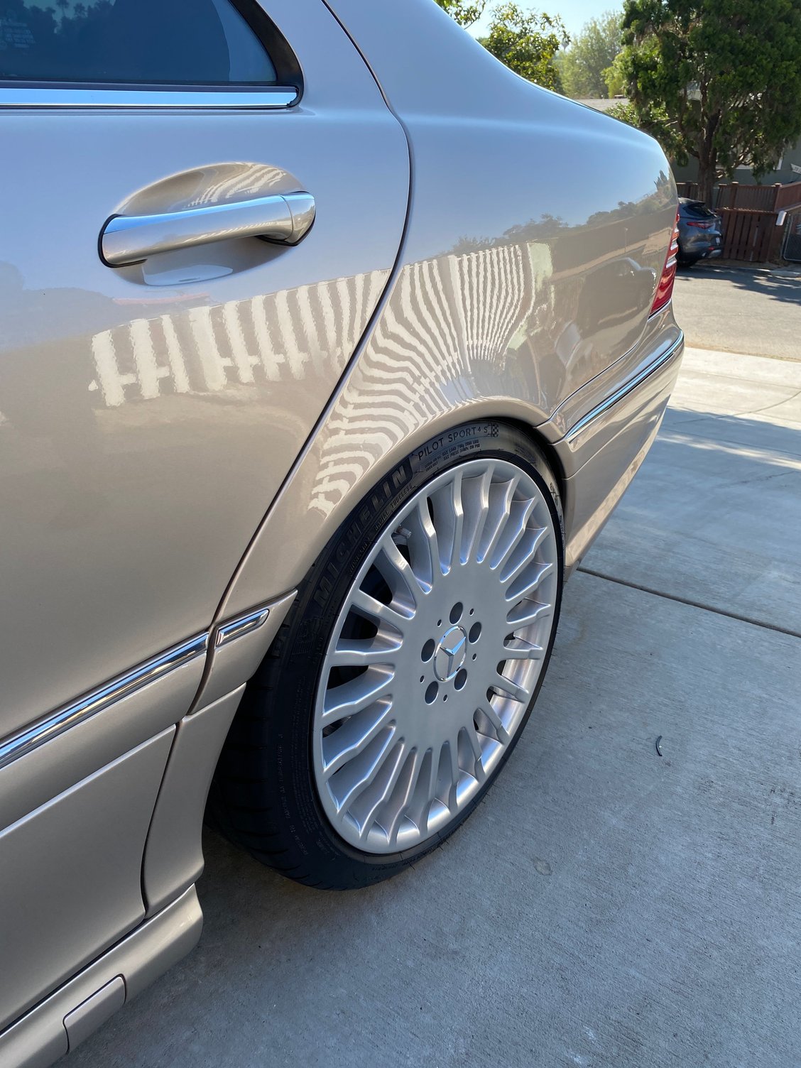

S55 is back and all but complete, just need to do 3 step paint correction as final step
Natural/Tan Coco mats, if you haven't had cocos you just need to do it, lots of color combos, made in the USA, look clean when dirty and cheap like 270 for a set custom made
New headlight lenses installed and front bumper repainted to correct some bad touch up paint/repair work from curb damage
19" S600 w221 Wheels 8.5 x 9.5" freshly refinished

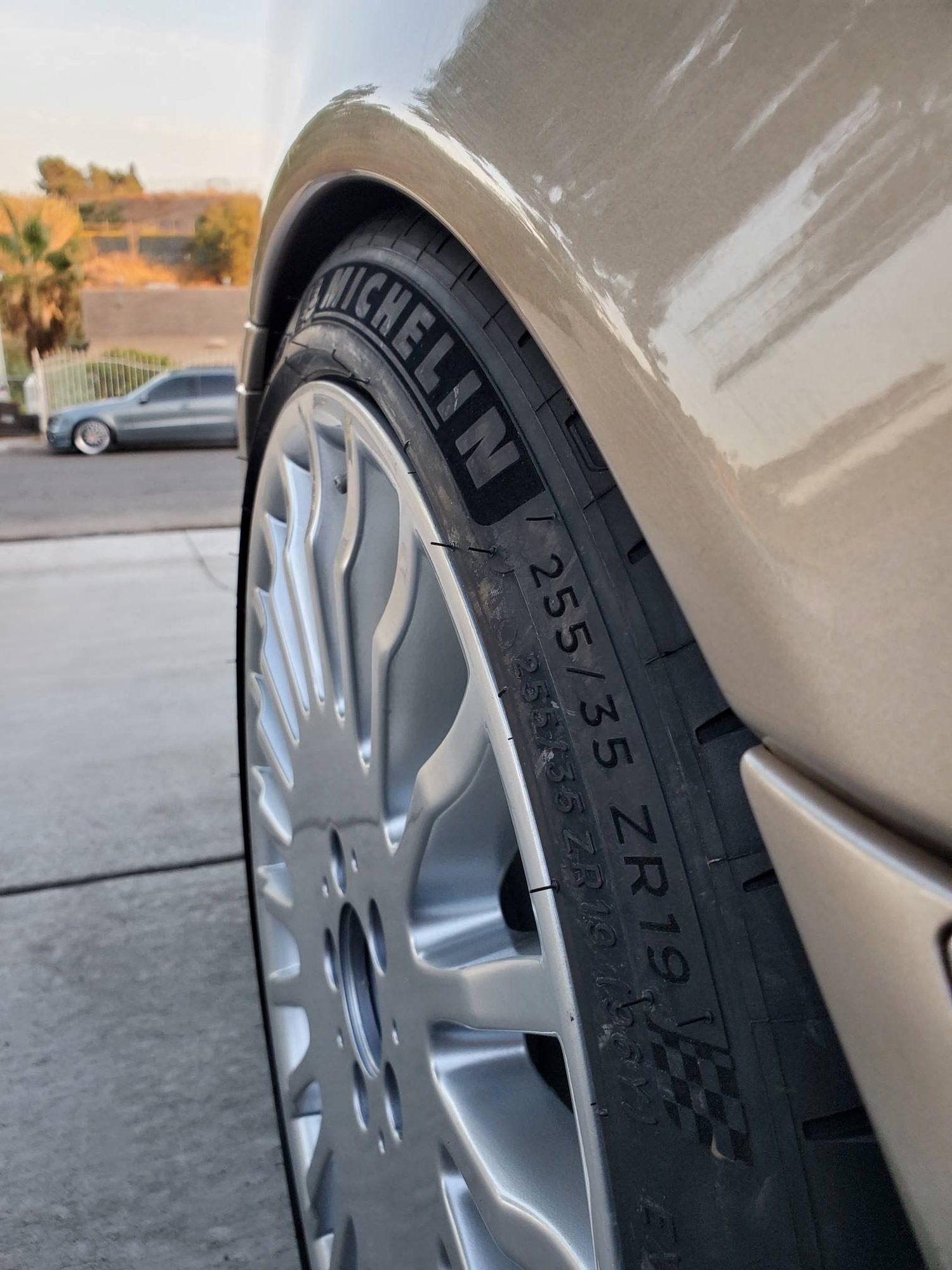

At San Diego Airport on its lowest suspension setting
255/35/19 in the rear on Michelin PS4S
225/40/19 up front
I wanted a quality tire, in a size that gave a little stretch which also helps with clearance
There is no rubbing on any of the levels shown in all of these pictures, even with 3 adults and 2 suitcases
We used 15mm spacers on the rear and 12mm I believe on the front, left a little extra clearance for turning up front as I really don't want to deal with rubbing
Driving down the 5 - this shows it on its lowest setting (3 total, this is all the way down)
A full day of fettling with the suspension to get the front to rear heights dialled just how I wanted, pretty even wheel to fender gap that gives the car a slight rake forward (perfect for euro in my opinion)
The gold pops in the sun
Big thanks to Clifton Mercedes for some of the heavy lifting mechanical work and the real superstar Adam from SoCal Tires Studio in San Diego (look him up on instragram) who partnered with me to execute all the details many of which we have not been described, we have probably 50 line items of things we did to this car to get it dialed from small details to big component rebuilds.
If you have a mid 00's AMG he is your man
It came out exactly how I wanted it and I love it.

one of my favorite benz wheels that retains the somewhat full face look I think is synonomous with 80's-00's MB

Looks great. The repainted bumper is going to get tore up again though; esp when you are driving around that low.

I would imagine those wheels will be rubbing the paint off the fenders when turning or hitting a bump.

The paint correction is going to transform the car. I couldn't believe the difference in mine. It took a couple weeks to get used to, and I'd owned it forever at the time. +1 on the Cocomats though... I've been through 2 sets of OEM mats and Coco are next. I'll keep the OEM for posterity. All of my other cars wear factory all weathers, which is more my style. These aren't robust enough.
