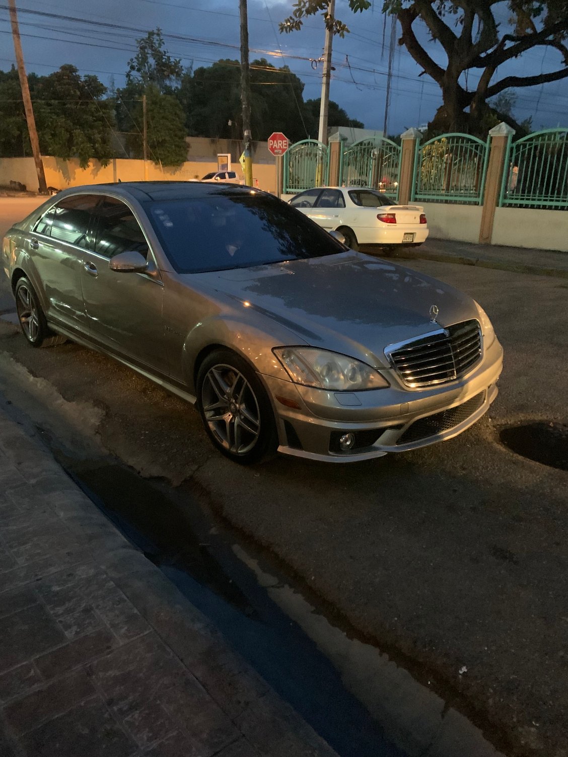

Hello everyone! So as I start my car today I hear a squeaky noice from the front and as I open up the hood of the vehicle I see a bit of coolant over the engine cover and a low coolant light (no check engine light) i moved the car and underneath was what looked like a glass of coolant on the floor. I’m not sure if I lost all my coolant driving it yesterday or what going on, any idea?
(picture just for reference) thanks in advance
