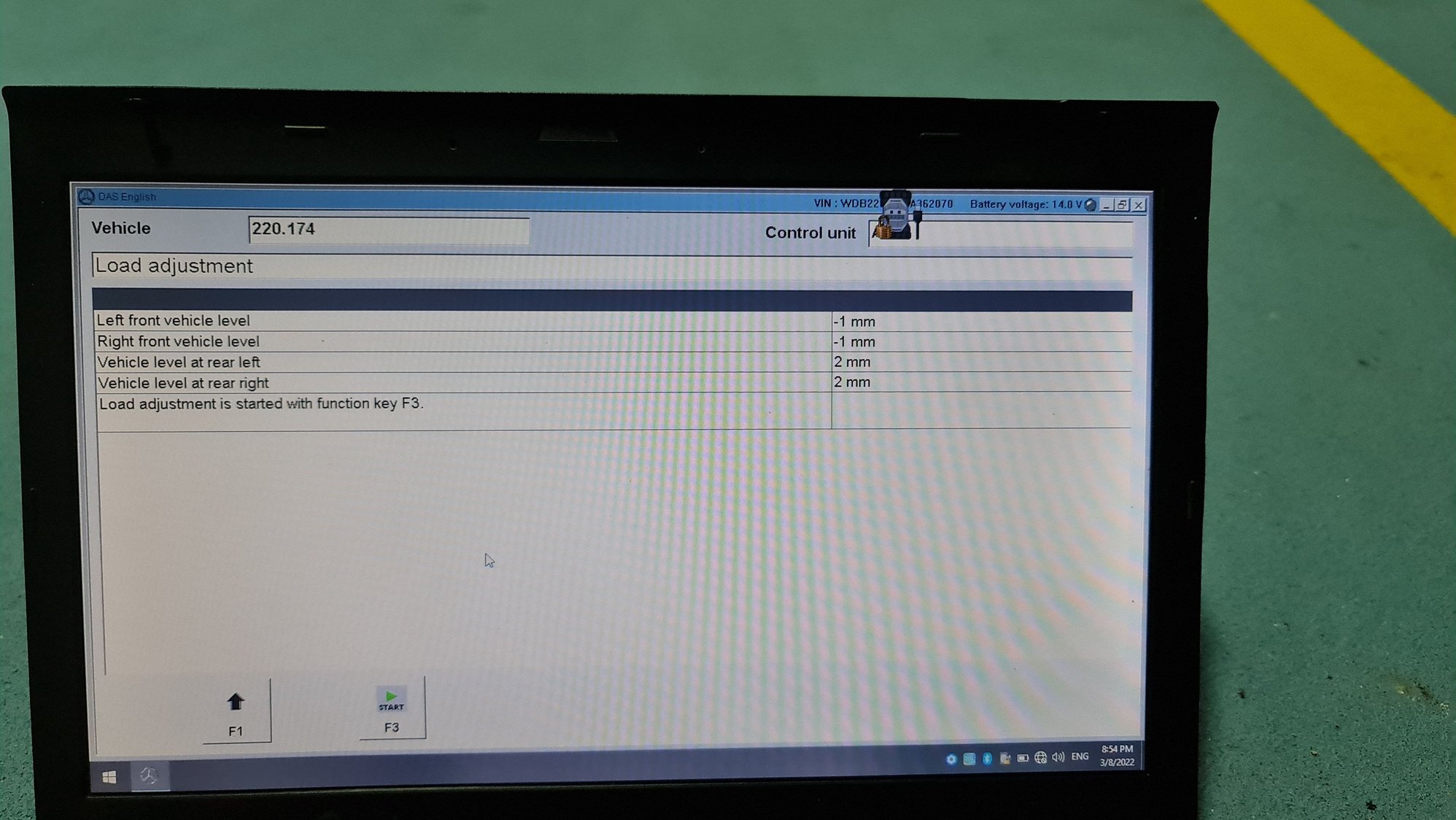

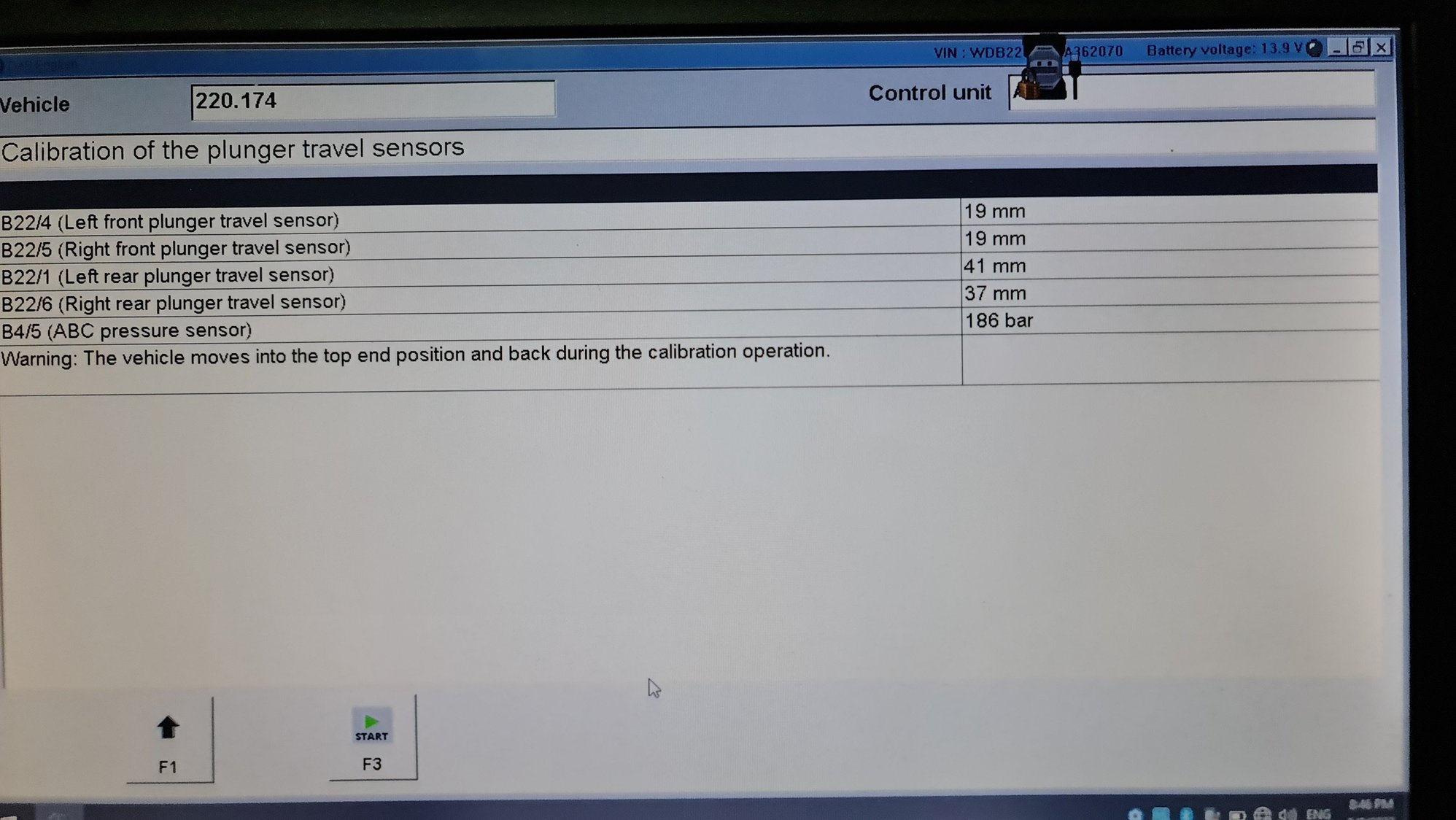

1- move toward calibrated level ( automatic)
2- calibration of the plunger travel sensors
3- actuation of level values ( here you lower your car as per as your preference
but INPORTANT NOTE: from my experience, the DAS lowering method will not allow the ABC suspension to be electronically lowered below 3.5 cm between the upper part of the tiers and the finder
4- entry of values stored in the inclination measuring instrument
- left front 5.0
- right front 5.0
- left rear -1.4
- right rear -1.4
and click F3 or OK ( i cant remember )
after that you should have l( level calibration successful)
5- load adjustment ( u should have a successful load adjustment )
and you are done
