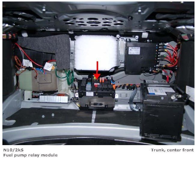

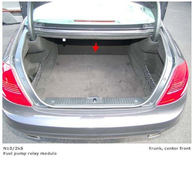

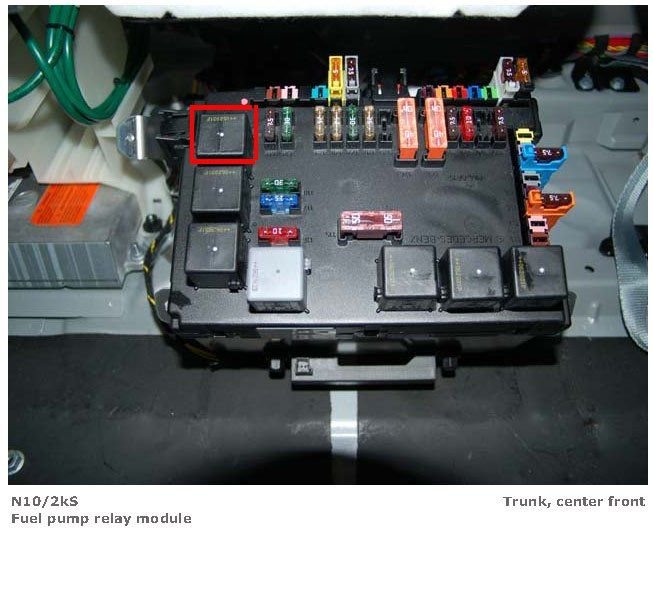

Hello, I just purchased my first amg. 2012 S65 and it's now not running at all. Upon warm startup it would start to stumble for a few seconds before it would smooth out. I parked it this morning and now it won't start at all or it will start for 5 seconds and stumble upon shutting off. New fuel pump, ignition coils and fuel filters. I pulled the codes from my Solis scanner and it read fuel pump module. I ordered a new one but can't figure out its location. Any help or advice on this would be great. I'm a mechanic but haven't messed with these before.

This is what I found for my '08 CL65:

Apr 30, 2022 | 08:30 AM
To get to that group of relays you need to pull trunk carpeting. I talk about carpet removal in my video here:
