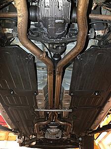

I think that’s right… primary cats in the downpipes, to a “center resonator” (the oddly shaped thing that people often replace for XPipes), to resonators under the rear floor pan, to mufflers. When I’m at a computer I’ll update this post with a schematic.
Here’s what people turn that into, with an XPipe and resonator delete.
Cheers,
maw
EDIT: Sorry, I cannot get the exhaust schematic to upload. But any dealer parts counter can print it out for you. The "center resonator" are not catalytic converters. They are hollow resonators connected by an H-Pipe, more or less.
Attached Thumbnails Does the 2003-2006 U.S. S55 AMG have secondary cats ? or are they just resonators ?-ef5b5eac-8c9f-4e14-9037-a736d827b4b4.jpeg
