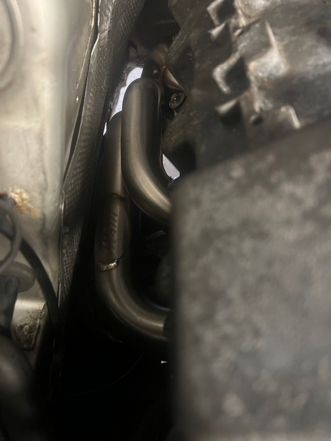

I just dropped some e55 headers in my 2003 s55. Previous post is basically correct, bend a couple heat shields, trim away the subframe (both sides) and you may have to re weld the outlet angle. Some cars, especially with worn or smaller engine mounts may be able to get away without any welding
