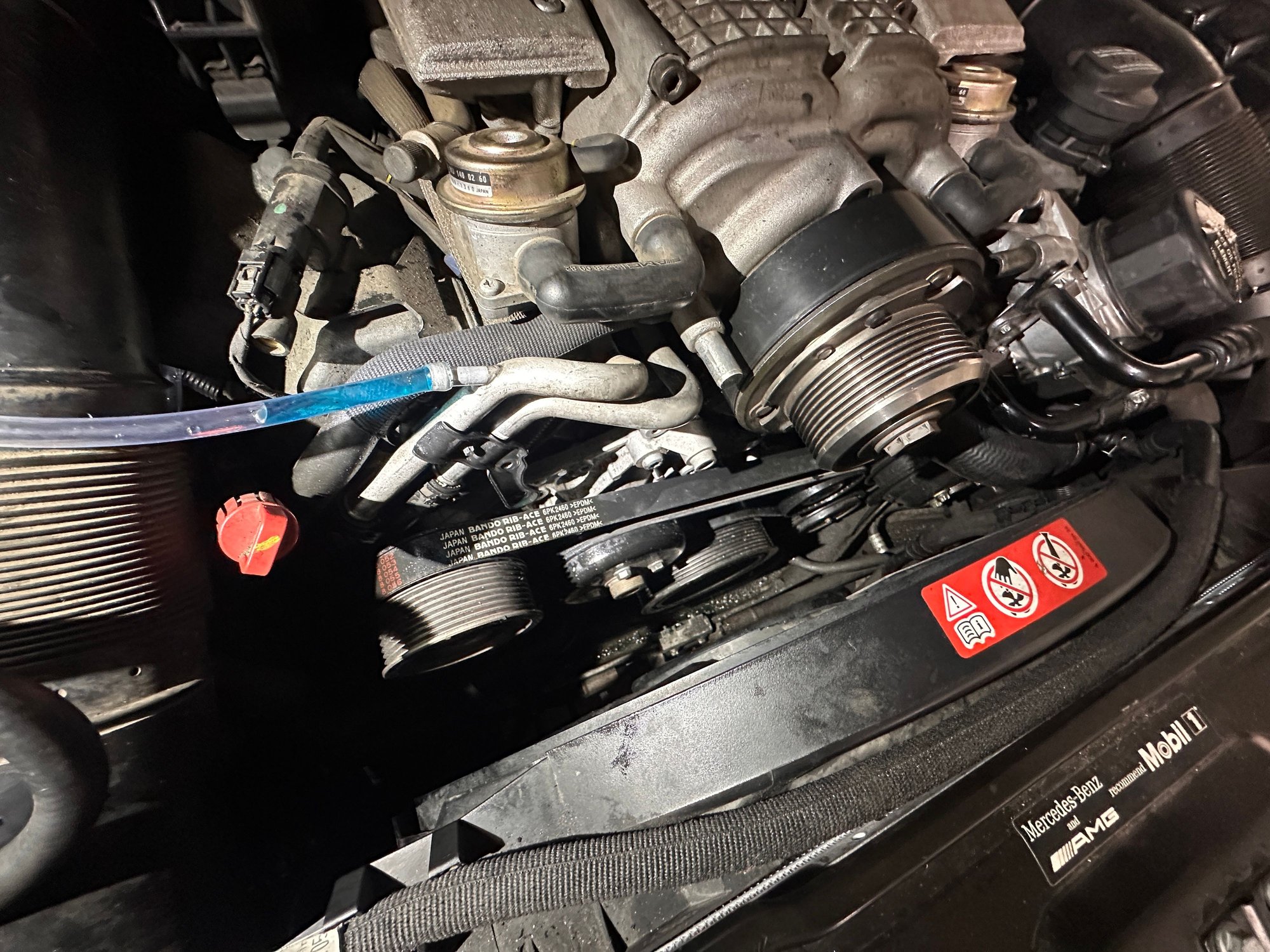

anyways, did belts and pulleys as well and refilled the coolant. During the bleeding process I connected a clear hose from the upper kompressor coolant line and back into the coolant reservoir to watch for bubbles but there was no flow with the engine running.

Old Dec 23, 2023 | 04:29 PM
Zoti's Avatar
Joined: Dec 2023
Posts: 5
S55 AMG
Engine
Image of the engine in question. This is before the kompressor belt and tensioner was installed.

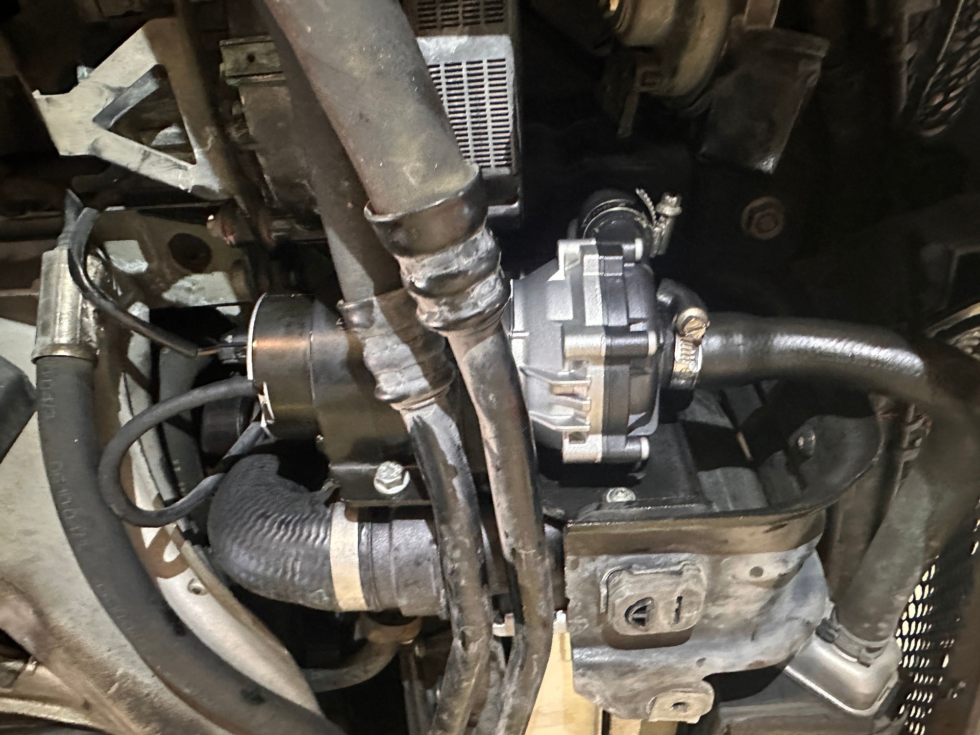

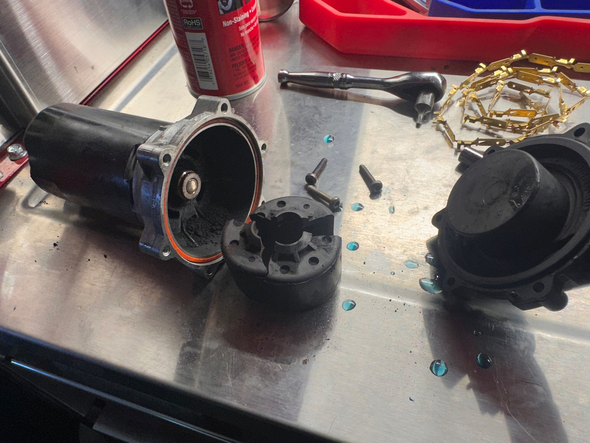

Zoti's Avatar
Joined: Dec 2023
Posts: 5
S55 AMG
After testing I decided to replace the pump. I took the old pump apart and it was running but broken internally.
the new pump is working fine.
