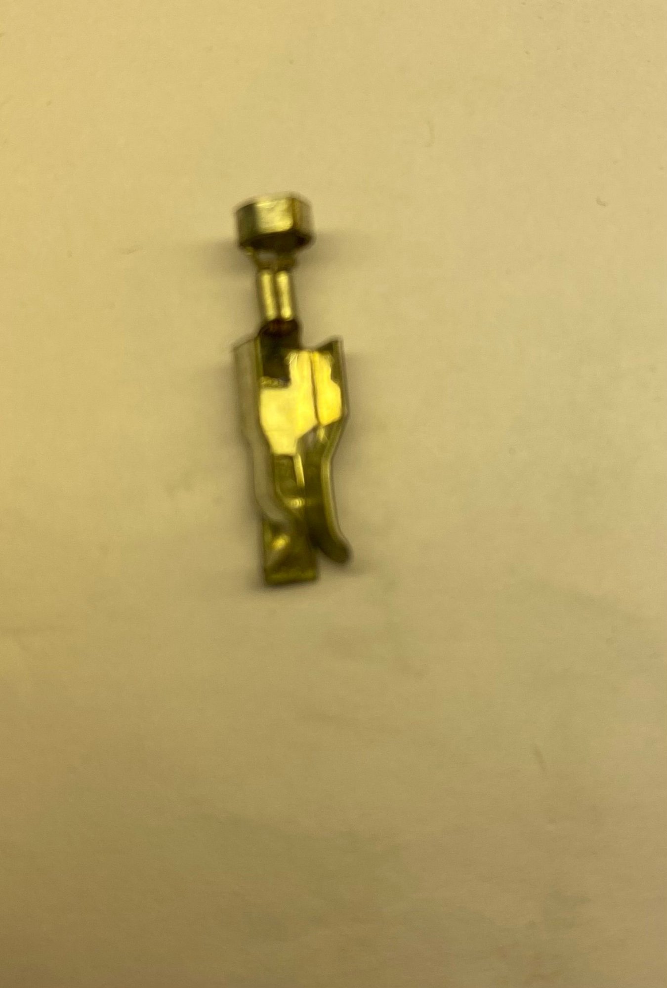

so I managed to pull the wires out of the front parking lamp connector. I have disassembled the connector and need to purchase new Deutsch connectors so I can re-crimp the wires. I've done some research, and it looks like there are many Deutsch connectors out there - I have not been able to find the one I am looking for. I think it would be easiest if I could buy a Deutsch pin kit for European cars, or even more specifically Mercedes or German cars. Anyway, I am hoping someone can point me in the right direction for the specific pin number I need, or a kit which would contain the pins. The pin holds the bulb when installed. I have attached a picture. thanks!

well, if anyone runs into this issue, it appears there is a kit available from Mercedes to fix it. Thanks FCP Euro for this information.
Marker Lamp Bulb Socket - Mercedes-Benz (000-540-09-66)
