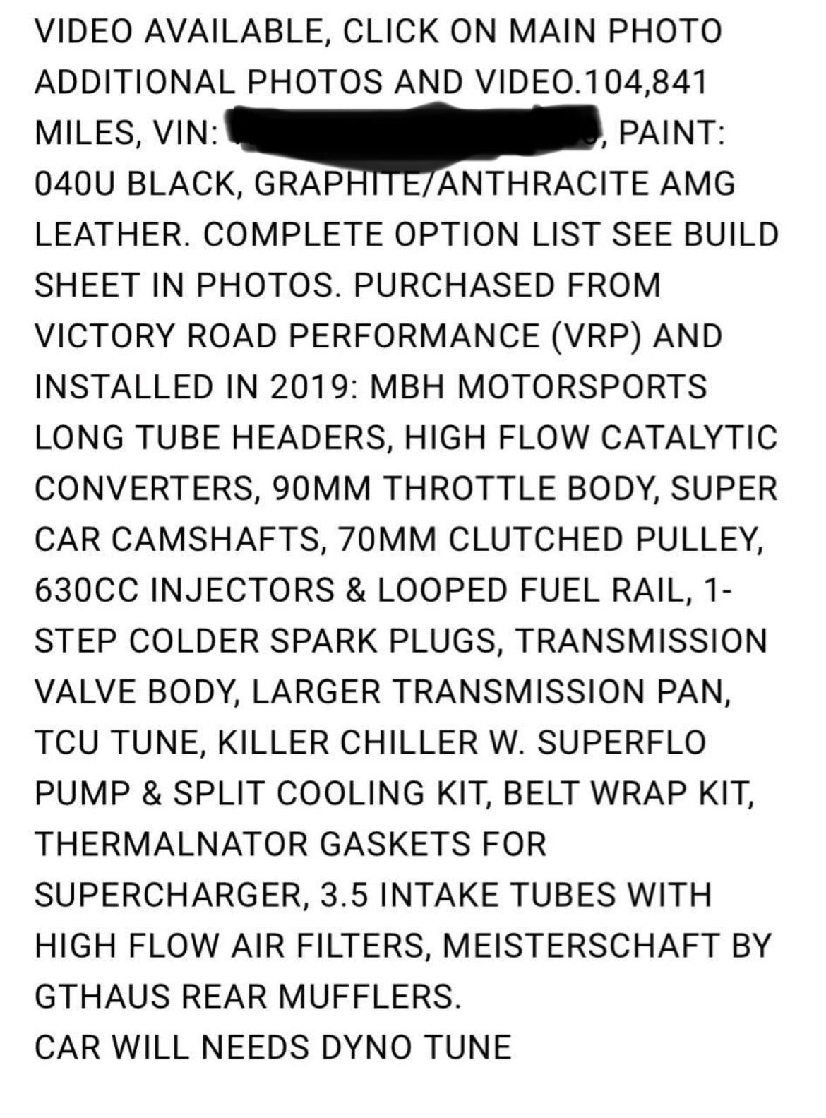

I bought a S55 AMG semi recently it’s been pretty heavily modified. One of the modifications is a split cooling kit, there is oil in the after market reservoir. I can’t find anything online on what could cause this. Any suggestions are welcome

Sounds like a really cool build and beautiful car. Do you have any pictures you can post? Would love to see the set-up.
I'm personally enticed by the MBH Long Tubes.
